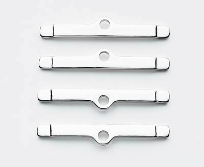

Those little spreader thingies to disperse the load of the fastener help out as well. Had to use a couple on my evil-bay cover to make it hold right.

Then I use some of the metal SBC valve cover hold down tabs. You can usually get four or five of them on (can't remember).
Make sure you don't overtighten.
