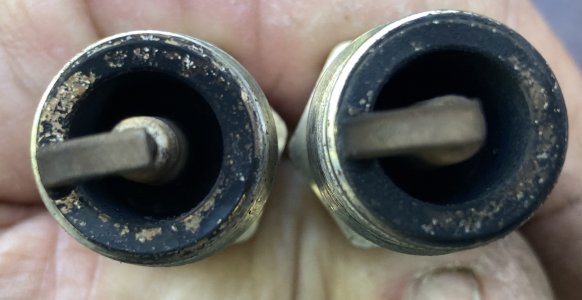

Took it for a drive on Saturday. Seems a bit dead/sluggish getting going but it scooted along at 55 easily. Here is a picture of the plugs after 20 miles of highway and country roads.
The one on the left the porcelain looks "grainy", pitted. May be the pic. If it is that indicates too hot of a plug. The electrodes would suggest a decent air/fuel ratio.
