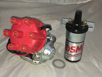

More than few site members used what's sometimes called the Aussie DuraSpark II Bosh electronic distributor perfect fit for the early blocks bolts in no block machineing required. Our site member " Xctasy " might have more info on how they are set up and work. You would then bolt in and use the 1965 up 5/16 drive oil pump and 5/16 inch hex drive oil pump drive shaft. I have seen new one for sale a few times on the Australian Ebay sales site nice looking and compact size. I going to do some more digging but it sure looks like you have one of the early 200 short blocks, I would sure use it especially since you also have the Dagham 4 speed that should be very good combo as well as being rare does your Comet happen to be a 1963 1/2 Fastback S22 or 1964? Personally I don't much care for the DUI or HEI in these early cars but they will work if you happen to go that way know that you can't fit them with the factory Ford power steering pumps they set up to high. After finding some adistional info I also went back and Edited and corrected all my mistakes so take a look at those again if you want. Found this on EBay.com Austraila so added into this post, it might be an aftermarket copy of one of those Bosch Electronic Distributor's it sure kind of looks like what I remember them to (see below link for info). Best of luck Edited
Ford Australian Six'es (fits the 188, 200, 221, & 250 pre cross flow engines) Electronic Distribitor (A Bosch Copy?)
Distributor and bosch type coil kit. With this distributor comw with an external coil, the 2 wires will hook-up to the coil and you're"ready to run". Nothing else required! 1, Bilt into the coil type ( GT40R Bosch ).

The Aussie DS2 sounds like a good deal. I can change out an oil pump. Or the black box, I'd want to read the instructions to see how it works. Thanks for all the feedback, I really appreciate it. I will get some more pictures of everything and post them.
