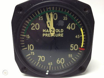

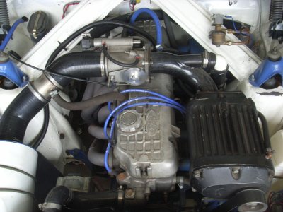

To add my comments, IMO draw through is easier, the carby does not know any different to NA application. As to the sizing of the carby/mixer in my case (LPG) although it is rated at 400cfm, which would seem too small for any great power, what happens is that the supercharger can create a much higher DP across the carby than the test pressure use to arrive at the CFM rating. I have a dual needle manifold pressure gauge on my car so I can see the DP across the supercharger and the carby. From my observations when driving, the moment the manifold pressure rises to jsut above atmospheric, even on small throttle openings, the suction on the carby increases noticabaly. IMO I would NOT use any centrifugal type of compressor for a street application, with one exception, a turbo that is FULLY integrated like the GM setup on the Equinox, and this ai almost impossible for any of us backyarders to achieve. Positive displacement superchargers deliver the best drive ability, torque is available at any time by just opening the throttle, you have virtually a much larger NA engine available. Draw through has one advantage over a blow through, that of latent heat from the vaporisation of the petrol, as stated above. I dont have this effect because I run LPG where the fuel is vaporised externally to the engine, however the knock resistance of the fuel means I have no problems with detonation even with 10-12 psi and 9:1 CR. Ill chuck up a picture for those that have not seen my setup before.

Its not just how much boost, its how often you use it. 12psi is usually plenty for a stock type of thing, and will wake up most engines. I can produce a lot more than that, but I find watching my gauges, that Im often well below that. I run all stock parts, Ive heard our pistons are better than US, this might be wishfull thinking. I have an advantage in that the crossflow head breathes much better than any or the log heads, boost cant make up for that.
