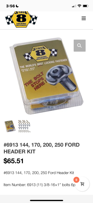

Yes, they do. 3/8-16. There is probably a range of preferences. I have used the Stage8 brand. They have a locking tab. Can’t say I’m really impressed though. As long as you can reach them to retorque. I would suggest using some kind of copper gasket. I have had some composite ones(white and black) burn thru.
The only problem with buying a kit for a v8 is you are buying some extra. If you have a hardware store that sells good stainless (magnet won’t stick to) you can just buy what you need.
