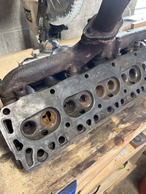

All Small Six Thread 'What to do about damaged pistons in 144'
Question from a beginner (be gentle haha). I have a 1961 Falcon 144 engine that I got for free off craigslist.
Posted briefly last year about beginning to tear it down here.
Well, as you can see from this photo, once i got the head off, it was in pretty rough shape inside. Standing water, wouldn't rotate, and several pistons were rusted in place:
I've made serious progress since then and have been able to get 5 of the pistons out, and the cylinder walls actually look pretty darn clean.
Well my question is about what I did to the pistons while getting them out...
