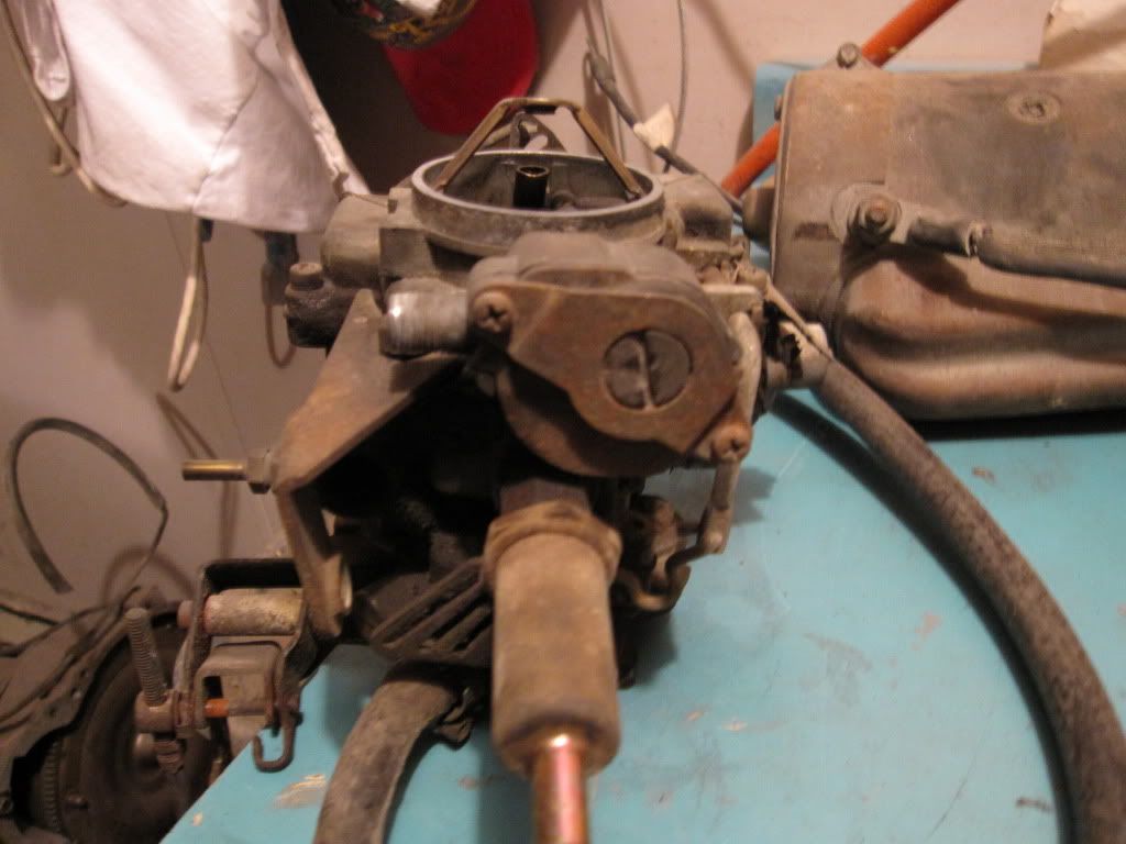

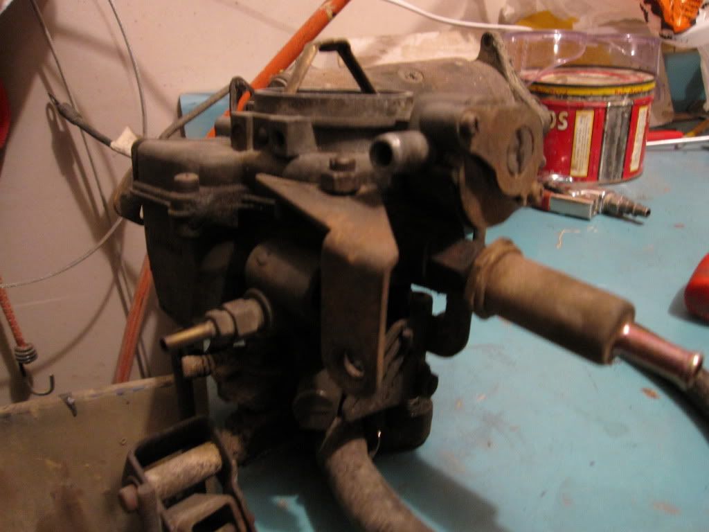

Looks good from what I remember mine looked like. Also, see the threads on the warm air feed to the choke. On mine those threads are the same as a 1/4" tube compression fitting. I went to the hardware store and bought a compression union, took the ferrule and nut off, slide them over the end of a 1/4" copper tube and used that. Make sure you put some type of insulation over the choke tube too. The radiator fan creates enough air flow to cool off the choke tube and delays the choke from fully opening.
