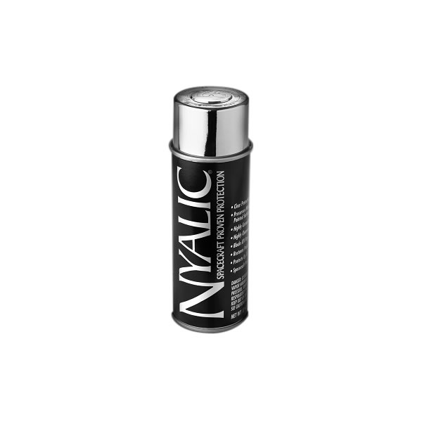

On a different note. I wish I protected my intake with a ceramic coating. (I guess I still can) But if you do not ceramic coat. I found some suggestions on a different forum.
