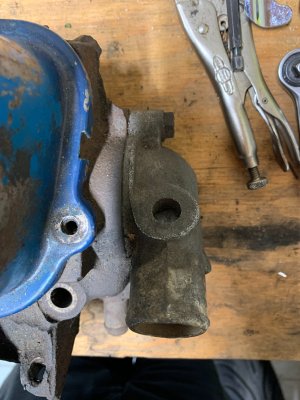

The SPAL in the above photo is part number 30101516. Mine looks exactly the same WRT the waterpump.
