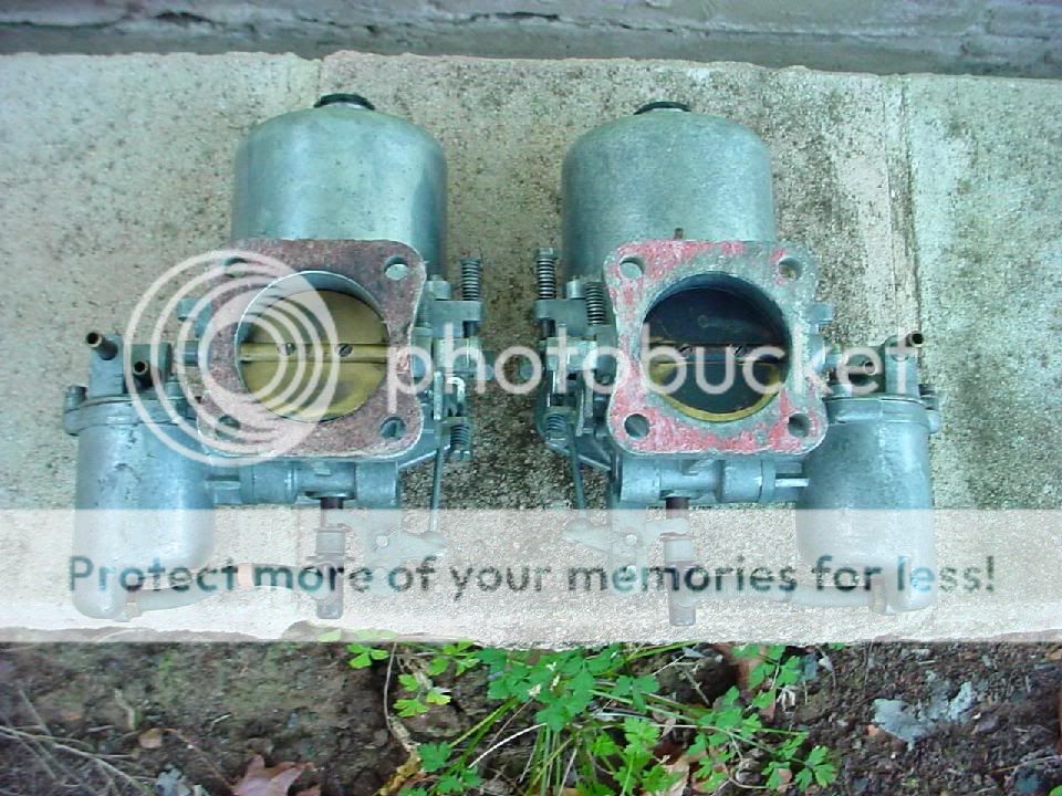

I've seen a dual side draught setup, home made (I could have it for $50 or a crate of Southwark Premium), also you can do your own with ¼" mounting plates brazed on. The CD175 and HS6 type carbs are side mounted. See this pic for an example of the side mount flange:
The "1V" bit has no effect on whether the carbs are up, down, or side draught type. What is worth noting, is that side mount carbs are pretty close to the exhaust manifold/headers. Heat soak can be an issue, also fuel leakage. :shock: The separate fuel bowls of this type pictured are IMO a means of abating the heat issues.
