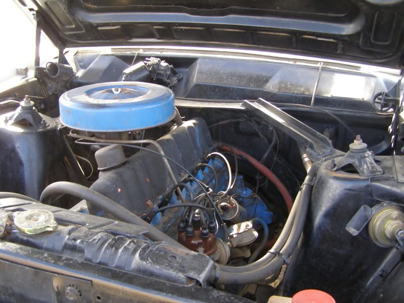

Slanting the small six.
ha - good find .
i wonder how the oil returned from the rocker cover as the pushrod holes are now at highest point
but at least the plugs are even easier to get at...

Confirmed that there was a 30 degree Slant Six conversion done to the XY 4X4. It was something I experimented with in Jan 2004 when I got a Nissan LD28 engined XC Falcon. The conversion is just to the right hand engine mount, and your concept is reality.
If you don't have a cross member, you have to convert to the latter SBF style item for V8 X-shell cars.
Its very easy to do. I was looking at doing it for my X-flow engine, so I could fit the RO34 Supercharger to my destroked 229 cube machine. It also allowed the easy fitting of the US SBF auto gearbox.
It's all in I'm gonna blow my budget and 25 degree slant six, all old HardCore posts back when I was a greener cabaage than currently.
Basically, the later Mustangs, Fairlanes, Torinos, Mavericks and Granada/Monarch/Versialles based on the orginal X-shell have a cross member, and the Aussie XR/XT/XW/XY/XA/XB/XC/XD/XE/XF/XG/XH sixes after 1966 to 1999 had simple cross members with a flat pad. You just take the right pad off, and make it flat, and you've get close to a 30 degree tilt almost instantly.
I've shelved the differnt stuff for present. A good deal of our Aussie Cortinas and some other vehicles like Explorers, early pre F100 Ford Broncos and Bronco ii's and Rangers aren't good candidates for slanted I6's; they have limited firewall space, but the conversion is easy for Fox Bodies where taller 250 sixes often portrude through the hood.
Pursue your goals. The Slant six Mopar's block is little different to our Ford I6's, and if you use Mopar engine mounts, you've got plenty of options.
