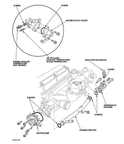

Here's a 2000 Honda, fan switch in the thermostat housing,
rNxjLKtPalTnEFax.full
There is no problem putting the sender in the thermostat housing. My efi sender is there and it barely reads 5 off from the sender in the head.
