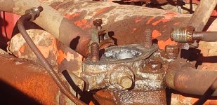

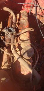

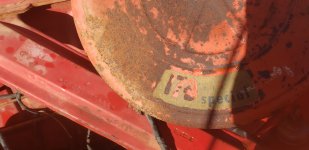

I know the 1960 models like mine all originally came with the 144 CID. I'm just going to post pics of what is in my engine bay. What say you, learned sixxxer wizards? FWIW, I'm 99% "Rod" is not a man's name in this instance.
The 170 Six came out in 1961 yours looks like it's a 170 to me. Look for the code on the engine front right side when your standing looking at the front of the engine its just under the head surface on the short block.
