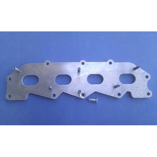

Ford 1.6 1.8 2.0 ZETEC to Crossflow Inlet Manifold Adapter Plate £49.99
10mm thick 5053 Aluminium CNC WATERJET cut inlet manifold adapter plate to suit the Ford 1.6/1.8/2.0 Zetec engine. This plate/stud arrangement allows the fitment of a 1300/1600 XFLOW manifold onto the popular 1.6/1.8/2.0 Zetec E engine. The kit consists of:

So my question is.. will this be close enough? (I'm thinking not, since I see references to CVH and Pinto motors separately)

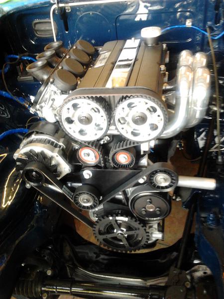

Another interesting find on that same webpage...
Ford Zetec E 37mm Bike Carburettor Starter Kit £350.00
danST Engineering are pleased to be able to offer this complete bolt on kit for the Ford Zetec E engine (1.6/1.8/2.0 blacktop/silvertop). The package consists of the following:
1x TIG welded danST Engineering Aluminium inlet Manifold
1x Set of 37mm Keihin or Mikuni Carburettors
1x danST Engineering Carb Fitting Kit (4x Fluoro lined silicone hoses and 8x stainless mikalor clamps) in red, blue or black
1 x danST Heavy Duty 1mm Thick Novus Inlet Gasket

That said, I think that flange will work, but it's not what you want. That flange lets you put the dual Weber crossflow intake from an old 1300cc motor onto your new Zetec. That's great if you've got one of those rare, expensive manifolds and you want your Locost or Escort to look right, but I think you have better options on a Zetec in a Falcon.

For example, the MS2 ($445) used with
Ford Zetec E Inlet Manifold for CBR1100 Blackbird Carburettors £166.66 ($241.66 US)
And then pickup off eBay a set of cheap CBR1100 throttle bodies like these...
04-05 Honda CBR 1000RR throttle bodies fuel body injector 1000 RR OEM 2004 2005 $29.99 (free shipping)
I'd be looking at Fuel and spark control with IR EFI for about $700
There are still places that I could save a few more dollars, for example if I made my own manifold, I'd be willing to bet I could get it done (although not as pretty) for under $60 (us)
And since I know nothing about motorcycle EFI, I'd want to do some research to see if the CBR1000RR wiring harness/fuelpump/ECM had the capabilities to be reprogrammed, and if so, how much are they selling for along with the required tools for modifications.
But it would have to be competitive with the Burton offering that I posted earlier
Ford Zetec E 37mm Bike Carburettor Starter Kit Price: £350.00 ($507.50 US)
And I'd also need an ignition controller, the one that comes up the most is the MegaJoltjr
Megajolt/E -- autosportlabs.com roughly $150
Total for carbs and ignition, $657..

*All* of those running options sound great. I had originally planned in injecting my Duratec, but none of those programmers have sufficient access to the emissions systems in the ECM I have, so I'd be faced with buying a different ECM & fabricating a wiring harness to make it work right, which as you point out costs money. That's what got me onto ITBs & bike carbs - it's about the same money as fuel injection, possibly a little cheaper, and I think would look & sound super under the hood. ;) The six in the car right now is already running on Megajolt, so I'm covered there either way. ITBs & a coil pack seems like a nice picture under the hood. ;)
It is crazy how expensive carbs are these days - you can buy a complete Megasquirt package for the price of a pair of DCOEs! Fortunately bike carbs are still cheap and pretty easy to source. They have a big following in the UK, but it seems a lot of people don't like them here. There are certain problems that are hard to address - throttle response, especially off-idle is the big one. For example, motorcycle carbs often don't have accelerator pumps. On a light motorcycle it's not much of an issue, but from what I've read they can have a gnarly stumble with cars. I'm sure it's ultimately all addressable, but I guess saving money on the carbs comes with the cost of additional, um, craftsmanship. :)
I have never driven or even seen in person a car with bike carbs so I have no firsthand experience. None of this stuff may affect a 2200lb Falcon with four carbs! It sure seems like something interesting to do, and I'm eager to try. Unfortunately, I'm a) really hung up on the transmission I'm going to use and b) I can't weld so getting the damn thing in the car in the first place is a major logistical challenge. ;)
