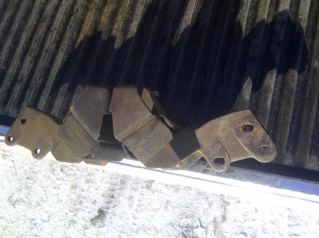

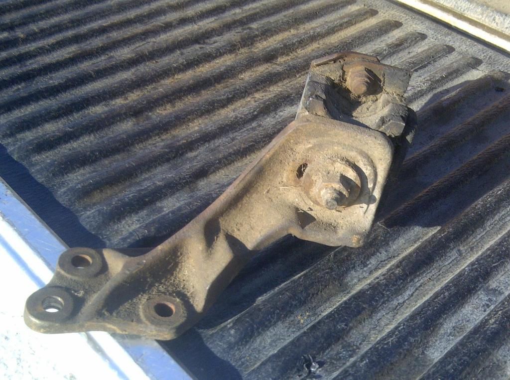

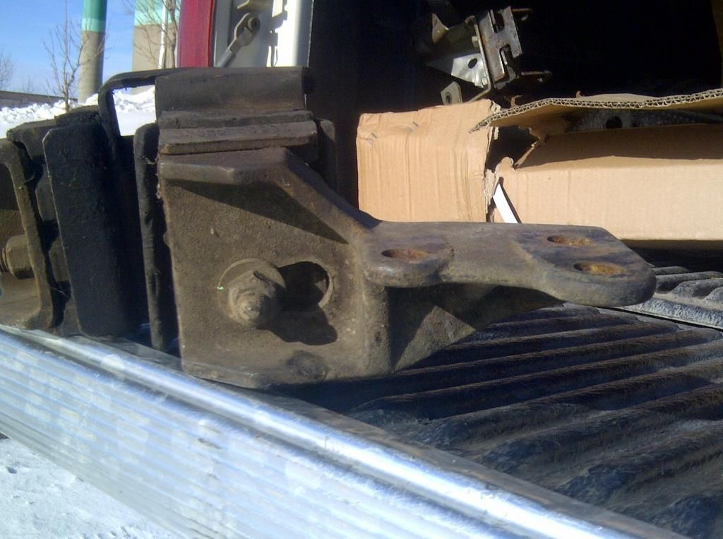

Today I give to you the dimensions of motor mount, I measured an aftermarket one directly off of a 1967 200 and compared it against one that is a factory stock part that is of a different design, but same bolt hole measurements.
This first picture is the aftermarket motor mount that I used for the measurements, and all the important measurements that you would need if you were building a replacement.
In case it is hard to read, the text from the pictures..
Measurements from points
A -> B = 2 1/2"
A -> C = 3 3/8"
A -> D = 5 1/8"
A -> E = 4 3/4"
Line between B -> E represents an imaginary 90° angle that originates in the center of the bolt that holds the motor mount onto the frame mount, and from that point it is extended up until it meets the vertical upright portion of where the motor mount bolts onto the engine.
B -> E = 4"
The angle of interest is point A and it is 60°.

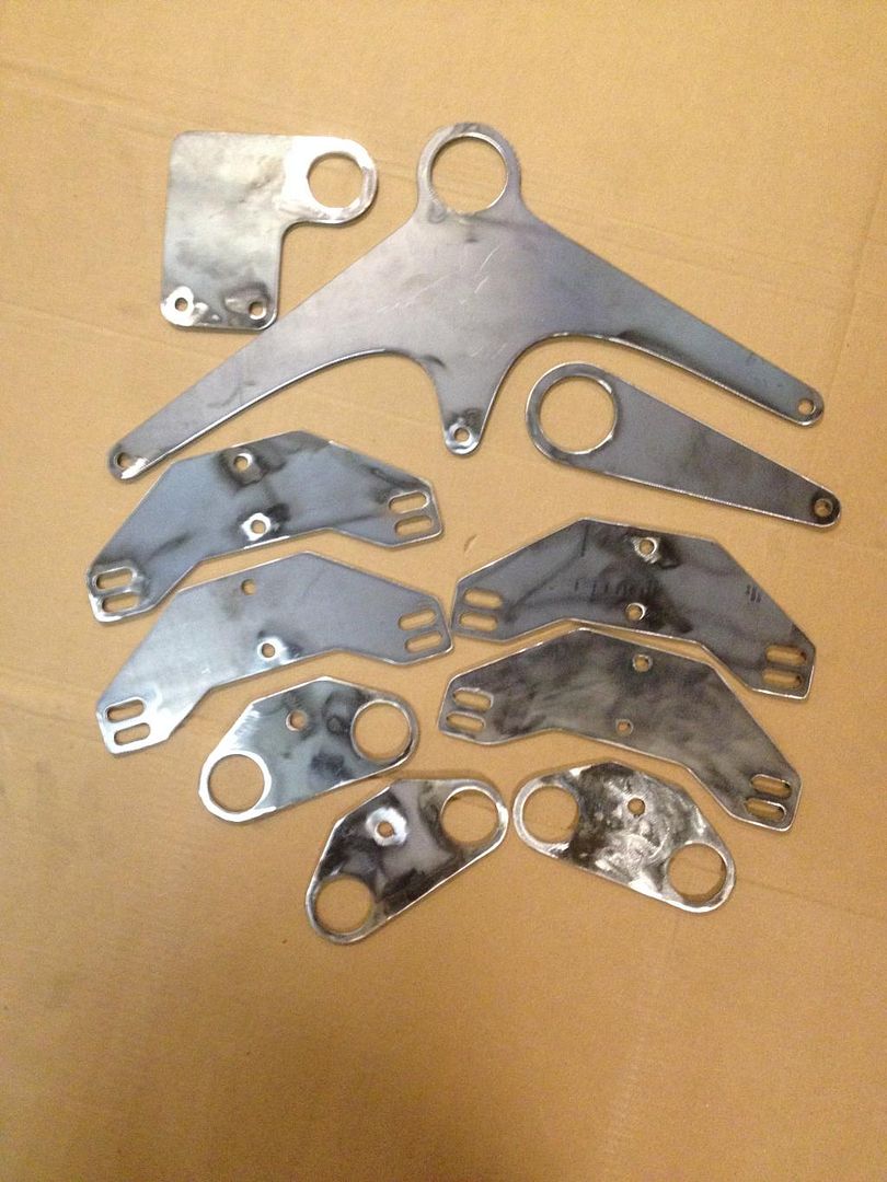

Kids went to bed, so I got back to work... Earlier this week I took a stock '68 Mustang Shackle bushing down to the steel yard and found some tubing that the bushing fit inside of nicely, it turns out that the tubing has a 1.5" outside diameter, and you need 2.5" of tubing to fit the bushings inside it. The mushroom end on the shackle bushing will extend .5" bringing the entire width of the tubing plus bushing to 3.5" wide.
So I got started.. First a new spin on an old design, a new motor mount.
This layout give easy access to the engine side bolts, easy adjustment side to side with a slotted bolt that mates the engine side of the bracket to the bushing side of the bracket, with 2 slots to choose from (5/8" apart, I tried it at 1/2" but with a .40 hole for a .375 bolt, it didn't leave enough "meat" between the slots)
So theoretically you could use these mounts on ANY small six. With a 144/170/200 use the bottom slot. If you wanted to fit a 250 the top slot (with 1/2" adjustment available) should drop a 250 in and get you remarkably close to a standard 200 height.
After the first sketch (which was full scale) I took a lot of measurements and turned it into bracket drawings.
This first bracket would bolt to the existing frame mount, would require (2) 90° bends, then weld the 1.5" tubing through the holes. If left un-assembled the end user *could* move the engine rearward .25" and weld them together themselves. the tubing would still be fully supported by the bracket.
Then I made the top bracket, just (2) 90° bends, no welding, bolt into place. There is a lot of 'meat' in this bracket as well where the bolts go through, I am certain that you could move the engine forward or rearward with just some new bolt holes.
After getting the full scale drawings done, I photo copied them and cut them out for test fit.
And by now most of you have seen the large gap between the inner bracket and the outer bracket, here is a picture of the 1.5" tubing with a shackel bushing pressed into it so you can see how much space it requires.
And now you know why my wife doesn't go out of town very often.. I will fill her kitchen counter and the dining room table with greasy/oily parts and then do arts and crafts.. :wink:
I am going to work on getting some drawings done so the plates can be cut out, I have to talk to the guys at work and see how tight we can bend items, not sure if I can get a bracket bent as I have designed it. But there are things that can be done, like if the full encapsulating round brackets prove to be too long (hit the bender when bending up the second side) I could either trim off the full loop so it is only welded on the bottom side, or make the bracket a 2 peice unit so that one of the encapsulating sides is 'weld on'. I tried to design it with very minimal welding, since I can't weld, I assume none of you can either, with a full encapsulating weld, it shouldn't take much more than a couple good tack welds to keep it from moving. And even if it breaks the welds, it won't be able to fully fail unless it tears through the encapsulating loop.
Questions? Comments? Thing this is the scariest thing you have ever seen?

I was up way too late last night... anyhow, at my work desk now I have these pictures downloaded from ebay of another somewhat famous engine mount setup. it uses slots and I have not heard (nor have I looked for) any problems with them having slots, and i would guess that the motors they are used with are slightly larger with more HP than most small sixes..
And just because I am a giant tease.. The other forum member took my measurements and created DXF/DWG drawings so I could make my own Strut Tower brace.. If he wants to put his name on this he's more than welcome to, but since I didn't ask if he wanted to be listed, I'm leaving his name out!

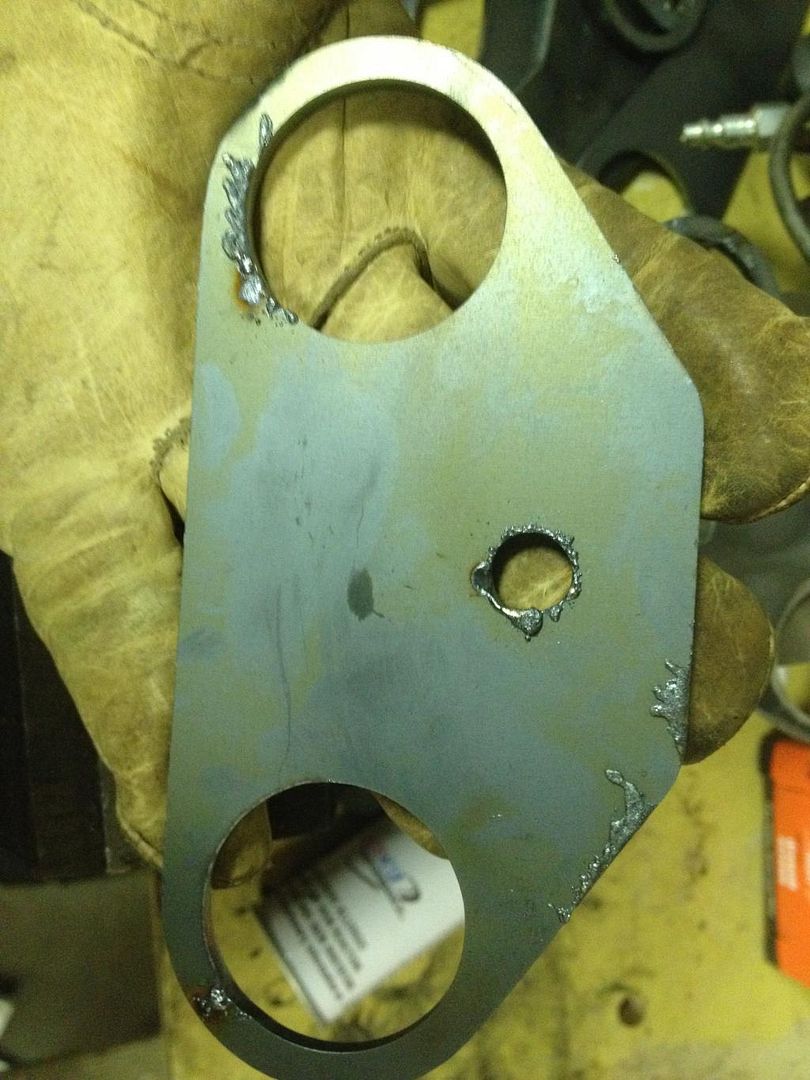

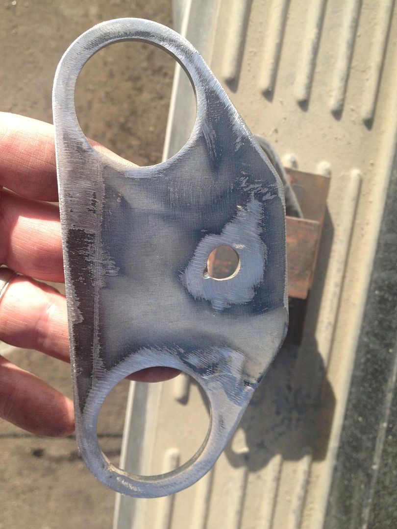

The paper drawings are ones that I made, I measured, then created a set from paper, then sent him the coordinates, he graciously sent me back the DXF/DWG. These ones are WAY too thick, the day I had them cut, he happened to be cutting some 3/8" so he just cut these out for me..
I have yet to order the threaded rods and heims. And I still need to figure out what I am doing in regards to the Monte Carlo brace..
And this is a set of motor mount plates based off coordinates that FTF posted on the forum a while back..
If you look at these pictures larger, you will see that plasma cutting does an excellent job on one side, but the backside of the cut can get a bit of splatter. I am willing to live with it, these are untouched, I will hit them with a hand held grinder and they will be perfect for my upcoming engine stand...
Just because I am at work, doesn't mean I don't know how to have a little fun... :lol:

Very nice on the cowl and tower brace plates :nod: excellent those are very clean cuts it looks like you have some nice equipment there to use :thumbup:

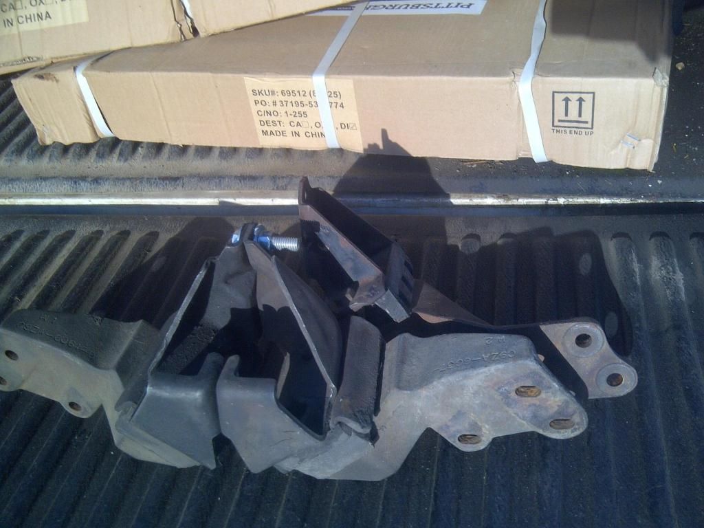

I had a little free time at work today and I poked through some HUGE PDF files that I bought a while back from eBay, thought you might like to see this.. and by huge, I mean this one has 2488 pages of information, but it is a scanned image of a book, so I can't search for anything in it which makes finding things very difficult.
Early Bronco Motor Mount Setup
I removed a bunch of stuff that was not motor mount related, but you can see from these pictures that the parts that make a V8 frame different from a i6 are Parts numbered 5057 and 5058, those brackets are welded to the frame rails.
Parts numbered 6038 are the actual motor mounts and while they have a slightly different shape, the still look like the same dimensions as the Mustang ones I have at home.
For kicks I called O'Reily's and Napa, they didn't even have a listing for it in their catalogs.

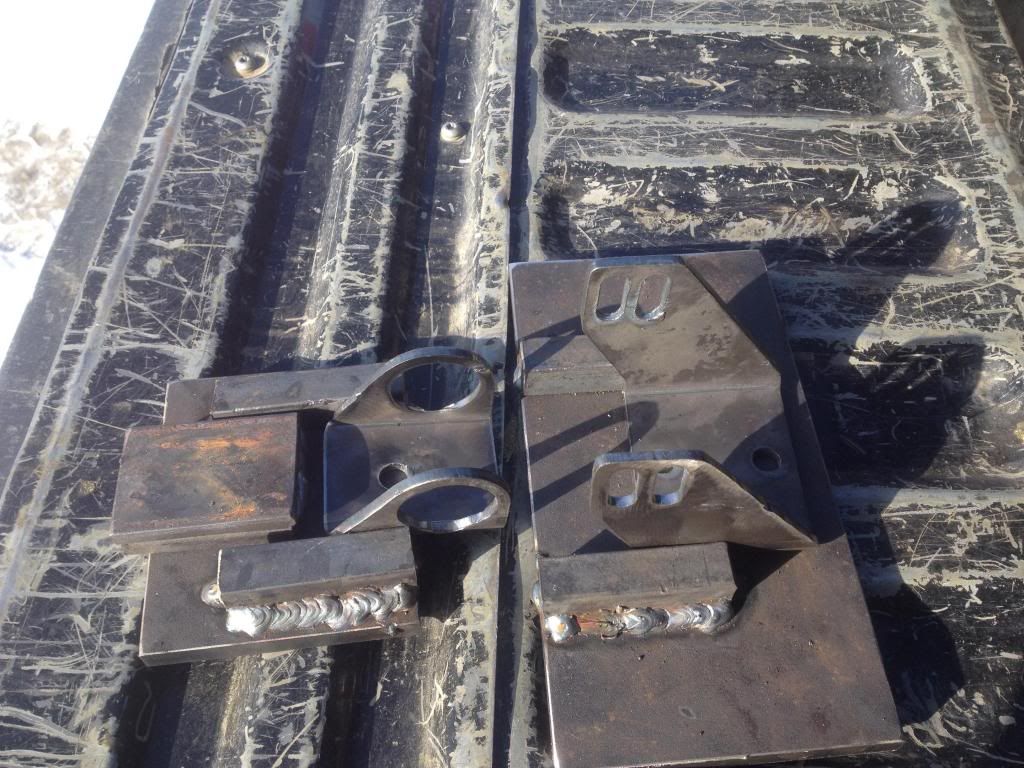

Only a mere year later.. I finally finish 1 of them.. :rolflmao:

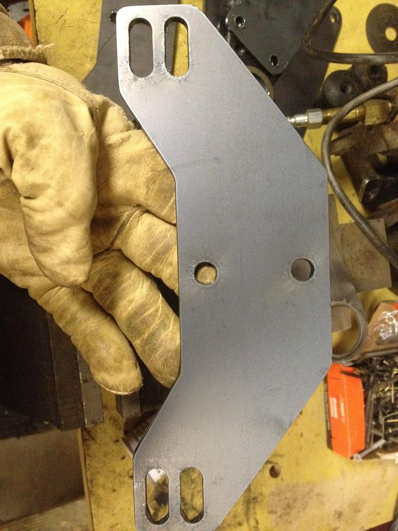

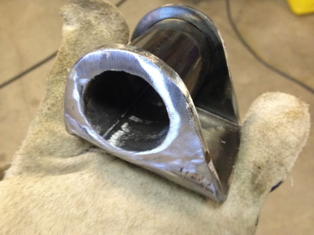

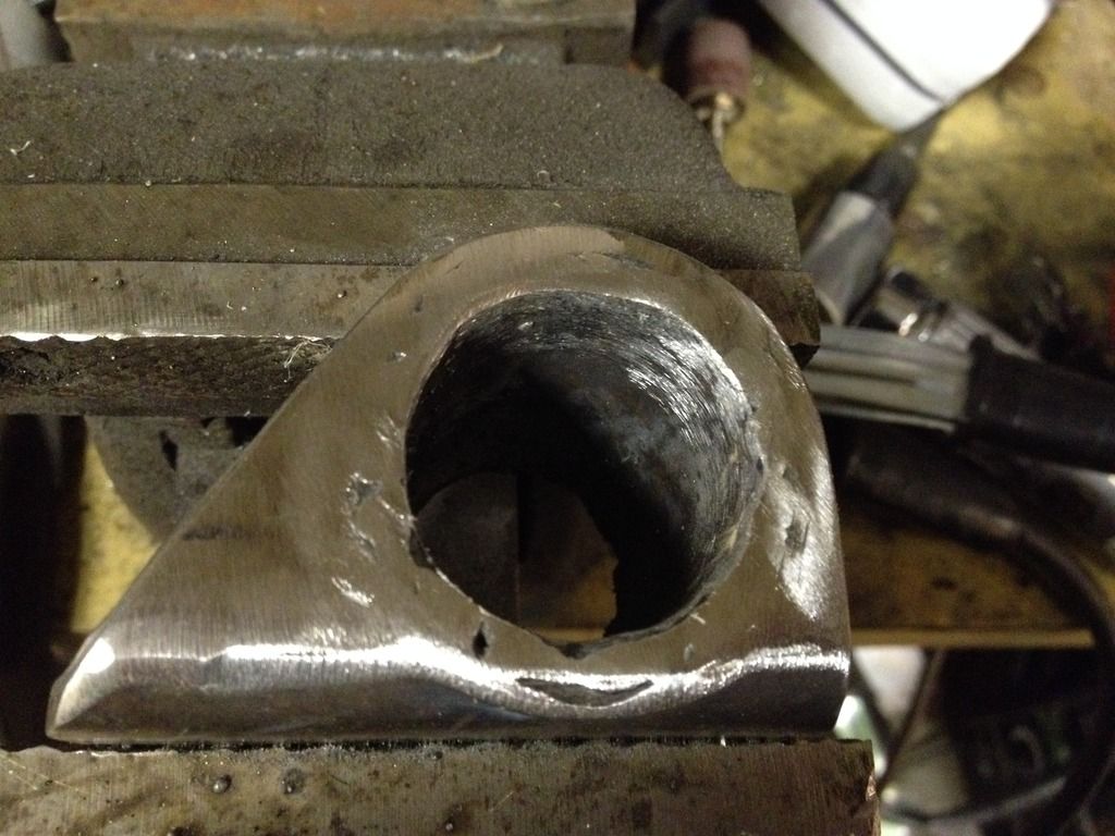

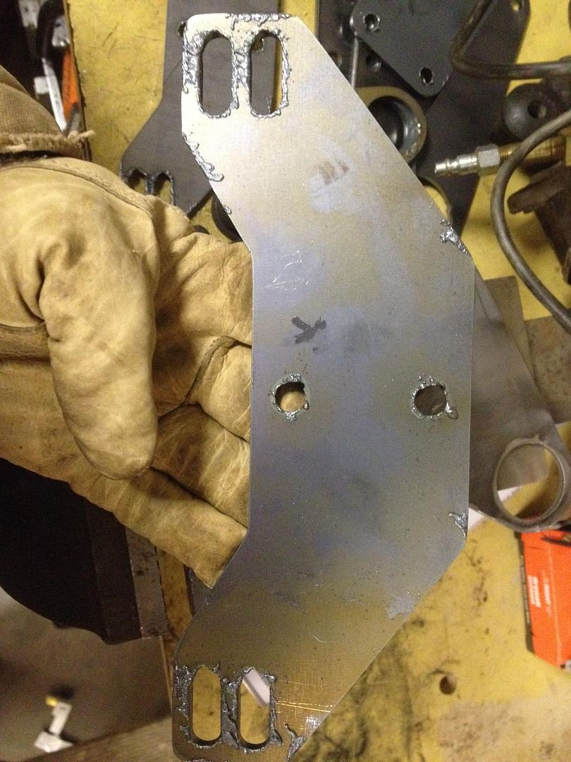

I had the plates cut last Spring sometime, and they rode around in my pickup or sat in my shop the last 10 months..
Fresh cut plates

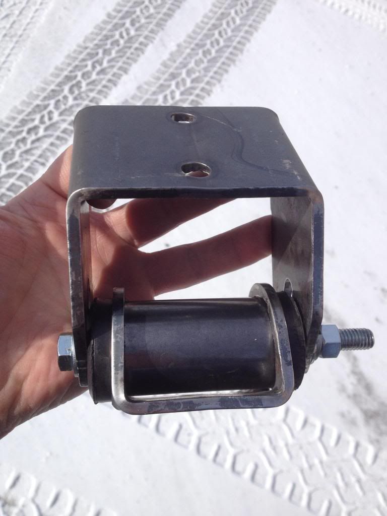

Where the plates were supposed to be bent, my first set are off just a little bit..

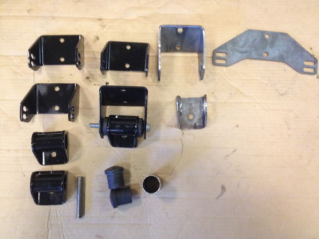

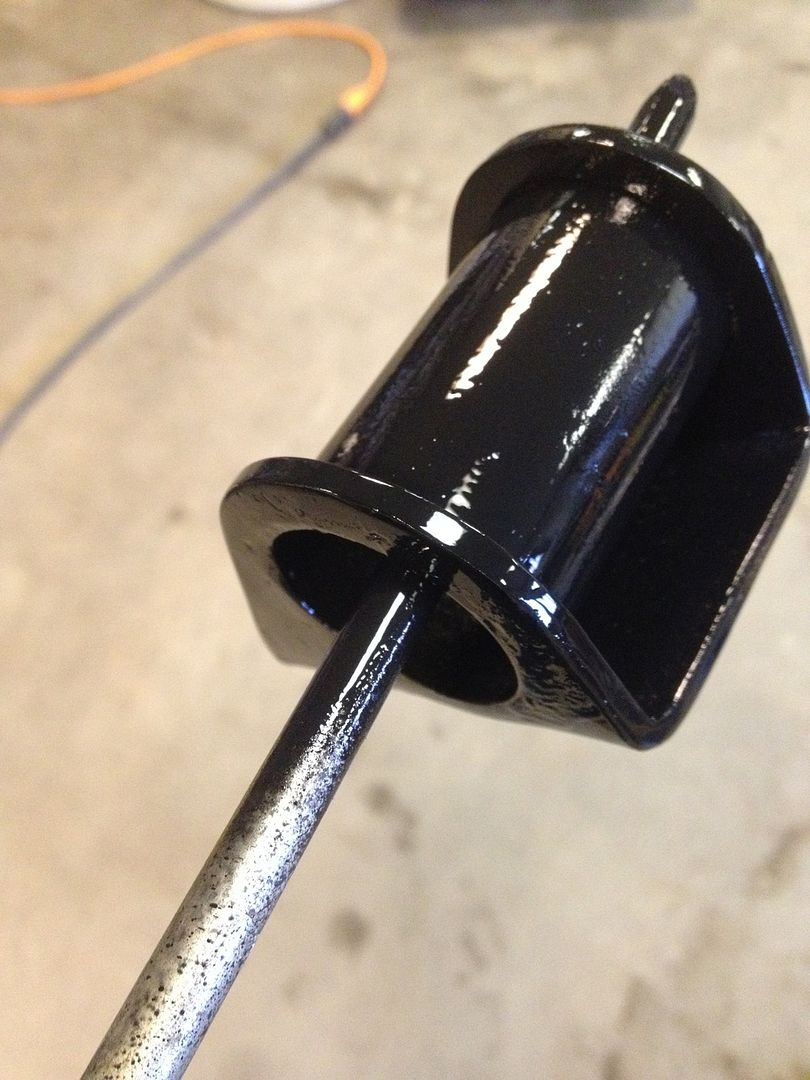

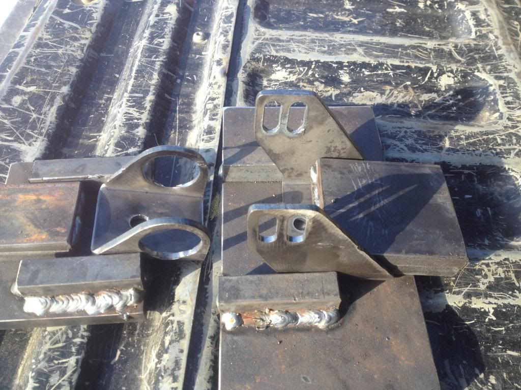

A set of brackets one without the bushing tube, and a complete setup for one side.
And back to back with a stock mount.
I'm trying to work with a local machine shop to have a batch of these cut/bent (properly) and hope to offer a few sets in the near future.

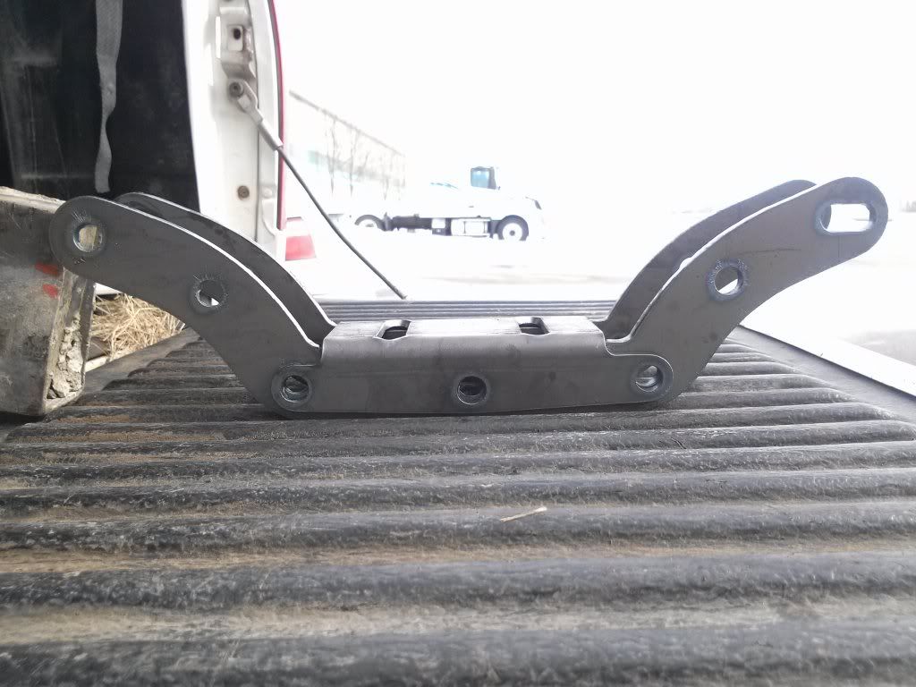

One step closer to being able to start producing these for sale.. I built a couple small die presses to bend the brackets on a hydraulic press. I think the brackets turned out a lot nicer than the first ones. FWIW, in order to bend the first ones the guy I had do it "Dan" did what they call break the back. So if you look at the first ones, there is a bend straight down the backside of it through the bolt hole(s). You can see it in this picture, the metal has an "S" curve right down the middle. If you look close enough you can see it on both top and bottom brackets.
Because our brake press dies wouldn't allow such a tight bend without the piece running into the blade/die.
A new set of brackets fresh off the press.
I'm actually pretty excited about the whole ordeal, since I now know I can bend 3/16" steel this way
Because it also paves the way for me to be able to make my other project become easier to do.. A '67-70 T5/AOD crossmember. (it bolts together). The only tricky part was how to bend the center piece where the transmission mount bolts down.

So after a lot of other life delays, I finally got 2 full sets created, finished, and painted.
And here are some build pics.
Cut some new plates
The other brackets in this picture which are NOT small six motor mount brackets are as follows from left to right
Small Six Engine lift bracket (bolts to rear passenger side of some heads that have throttle linkage pads)
The BIG bracket is a Ford 240/300 lift bracket that bolts onto the intake/exhaust bolts.
The small one on the top right is a single hole lift bracket, originally designed to be used on a Ford 240/300, but I suppose it could be used anywhere..
Then the bottom brackets are the ones to be used in building small six motor mounts.
For those that don't know, plasma cutting leaves a little 'blow out' or slag on the bottom side when its done. These plates are fresh from the CNC table, no grinding has been done on them yet.
Small bracket
Front Side
Back Side
(bolts to frame bracket)
Big Bracket
(bolts to engine)
Front
This time I was lucky enough that the CNC Brake press operator at work bent the big brackets for me
For the small brackets, I was not so fortunate, so I used my home made press brake jig
This is the backside of the small bracket after the plasma slag has been ground off
The downside to the small bracket is that I had the large holes cut to be almost exactly the same diameter as the tubing that I want to put through the hole.
In every case I have had to use some sort of die grinder to open up the hole after I had bent he bracket. This is mostly because the hole edge closest to the bend is deformed slightly during the bending process.

Some of you may recall that I bought one of the cheap spark boxes from Harbor Freight recently, I did a write up on it.
HF 90Amp Flux Core MIG review -- FordSix Forum
That is what I used to do the welding.

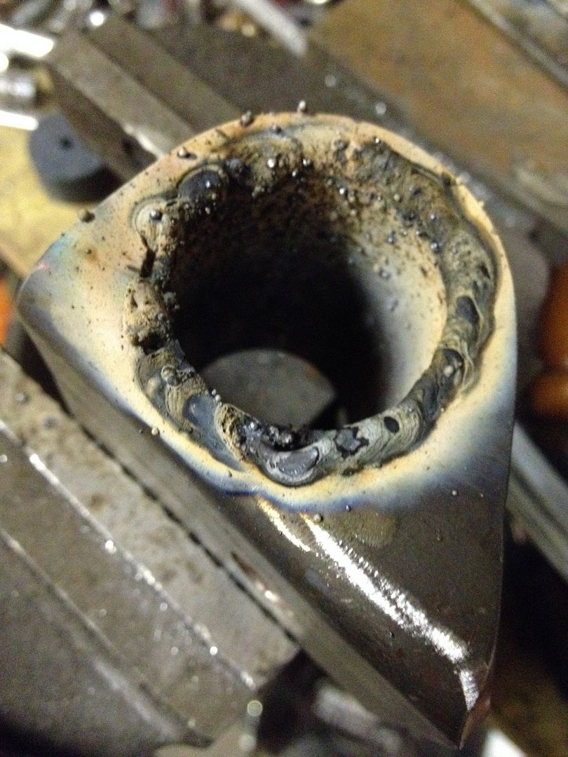

My coworkers say that we have some spray here at work that I should start using to prevent splatter balls (BBs) from sticking to the metal in unwanted areas, I really should try it one of these days.
Not the greatest weld, I fixed the gaps later before grinding
It got toasty warm, it was hard to grab the camera and take the picture so fast, so the image is blury :?
I ground that flat and used a grinding stone to remove most of the welding slag from the center hole
Repeat the same process for the other side and then I ended up with this

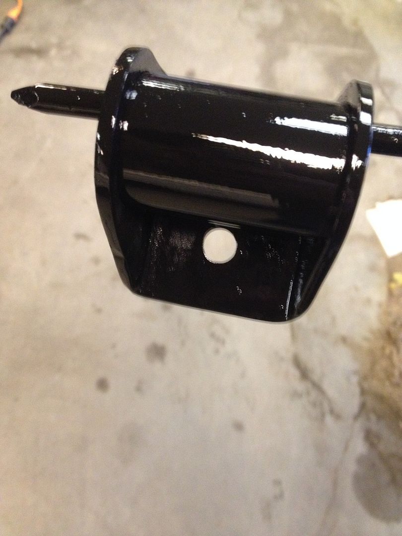

I applied some Valspar Black primer/paint to the whole thing and got this
And then repeated the process 3 more times (to make 2 complete sets)
Here are the components in various states of building.
Raw flat plates on the right, followed by bent unfinished plates in the middle, along with a section of the tubing used to hold the bushing, and a 3.5" long 7/16" OD piece of tubing that is used as a spacer in the center of the bushing. The rubber bushings are standard/stock 1968 Mustang bushings, I assume they are the same for all Mustangs that use 2.5" wide leaf springs. And then on the far left are (almost) enough brackets to make 2 full sets of motor mounts. I say almost because the 4th and final small bracket was still hanging up after getting painted.

And viola! A fully assembled small six motor mount. In this picture the bolt hole being used is the one that would be used if you swapped in a 250, or wanted to lower your 144/170/200 an inch.

Nobody makes replacement motor mounts for the '69 or 70 cars with 250's
But if they did, they would exactly like this set that my father in law pulled out of his '69 Mustang when he "upgraded" from a 250/3.03 to a 289/4spd (yes I am still annoyed at him, but at least I got the mounts)
250 mounts are the front set
'69 250 mounts on the top, an Oz 250 mount on the bottom (slightly grey/greenish)
Just look at how much more 'beef' there is in that 250 mount compared to this stock 200 frame/motor mount
I measured the setback once, I'll see if I can find the thread. If I can't find the thread, I'll re-measure them tonight.
Take a gander at this thread
250 Motor Mounts -- FordSix Forum
Forum Member "Econoline" posted the following picture, and you can see that the frame bracket hold down bolt is at least 1" rearward from the engine block mount bolts. Which would be pretty much what you said you had problems with.
Econoline wrote:Here are the 1970 Mustang 250 motor mounts I have.
Now my assumption (when I find my original measurements or when I get home) is that the stock 250 frame side brackets already have this difference built into them. So that when the motor is installed the bellhousing is virtually in the same location as a 200 or even a SBF. But when you were mixing and matching a stock 170/200 mount the offset worked against you.
Now if that is the case, you could still use the mounts I made, but you'd want to drill a second set of holes in them.
The big bracket that bolts to the engine has enough material that you could easily drill a hole 1" forward or rearward of the original/center mount holes.
Measurements for the 250 mounts are on this thread from eons ago (circa 2005)

I used a peice of 2 by 2 angle iron for the measuring jig. I started by drilling the lowest hole into the angle iron. I then put a bolt through the hole with the nut left lose so I could swing the assembly. I used the '67 frame and motor mount for the next step. I put a level along the motor side of the motor mount and when it was straight up and down I clamped it with a big pair of pliers and ran a drill down the hole that would be the farthest from the motor to mark the location. I then took the frame mount off the jig and drilled out the hole. After the holes were drilled I bolted teh frame mount to the jig and started measuring.
From the end of the jig to the horizontal motor mount face
'67 9.5
'69 9
With the motor mounts oriented as they would be while holding the motor
From the table to the center of the lowest motor bolt
'67 3 5/16
'69 3
I then tipped the jig over on its side and measured from the counter up to the center of the bolt hole that is closest to the jig.
'67 5 1/4
'69 4 3/4
So according to what I found, the '69 frame and motor mounts should lower the motor 5/16" lower, and they make and adjustment to allow for the wider block. The part that was interesting is the 1/2" setback. I noticed that the '69 frame mounts have oblonged holes in them for additional adjustments. I still need to make measurements for the bolt spacing where it bolts to the frame. You also have to allow for some slight miscalculation of measureing as I did it with a tape measure.
