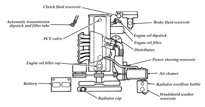

Here is how it looks on a 2.3 Lima block in the 1979 Fox Mustang/Fairmont/Zephyr engine bay
It is called a crankcase oil/air separator or a positive crankcase ventilator oil separator.
It helps to relieve the positive pressure that is built up in the crankcase. It is a box having one hose runing in and one running out. One of the hoses that run from it is connected to the PCV valve

"...Ford additionally has some 90 degree bend PCV's…."
sounds like the easiest.
Weren't (aren't) they the ones that look like the standard oem (seen in ur stand alone pic of the lill silver 'pregnant tube' having the hole on each end) but with a small (1/4 inch?) hard plastic 90* fitting on one end? Can't remember if that's before the PVC or after. If after it seems it wouldn't serve our (baffeling) purpose, just a 'reducer' for the carb line...
