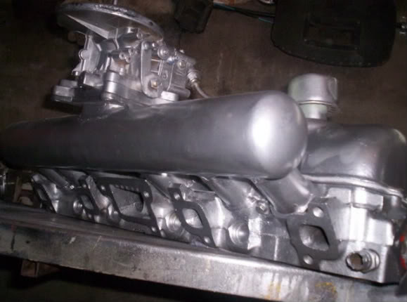

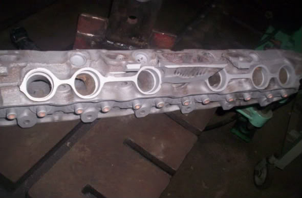

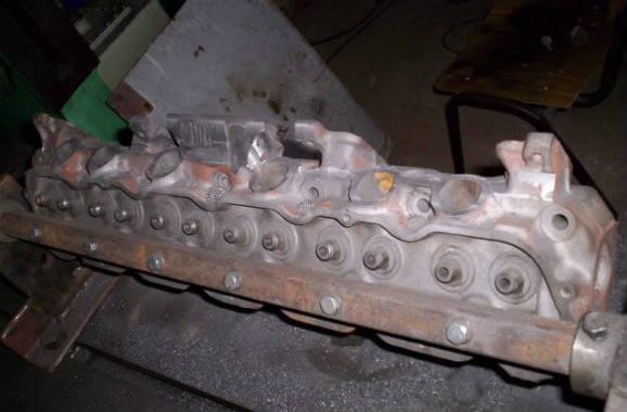

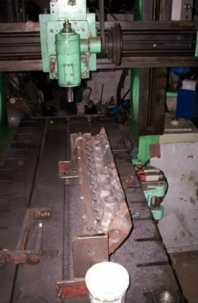

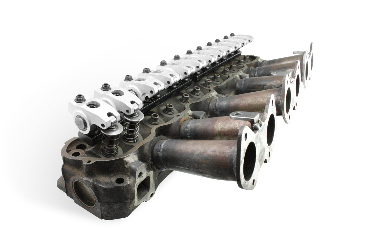

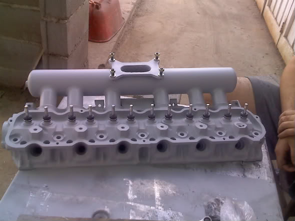

So I finally uploaded pictured to my website, to show what I want to do.
The first two pictured show the head with the log milled off. You can see that head is at an angle so the plane of the milling is perpendicular to the path of the intake runner. The intake runner travels down and to the right from the intake log to the valve pocket.
The third shot shows the intake runner bored out with a boring head so that new intake runner tubed can be inserted. I don't know if they are interference cut, or clearance cut with a method of securing them.
Then there are a couple shots of the heads with custom intakes attached.
And finally, a different set up with independent runners for DCOE carbs.

These are all other people’s pictures unfortunately. I still need to fab my assembly to hold the work piece. I wish I could just clamp it to the table and go.
magnetic chuck w/V blocks?
weld upa jig?

What kinda miller(s) do U have?
