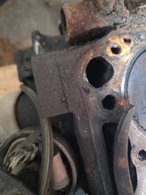

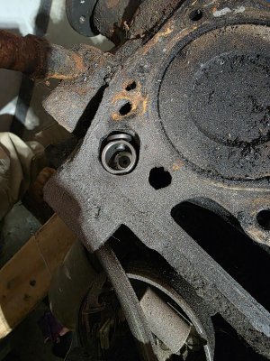

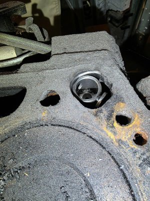

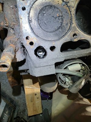

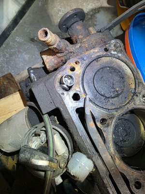

OK. So good news, I got the first one in with some work. Now I have to figure out how to get the 2nd one in.

In general, the galley isn't as deep so it's more difficult to get the longer lifters aligned with the bores. So I'm having fun with trying to get the full lifter down below the deck. When I did this before, it was with the non-linked lifter. We will just have e to see how it all goes...
