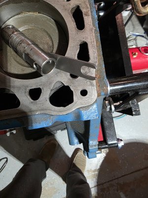

pic 1 you got 3.120 on my 250 I got 3.146 on 200- 3.140
Pic 2 you got 1.029-------------------1.039...................1.040
Pic 3 you got .585..................................... .576.................. .572 But I meaursed closer to the tip of lobe and it is thinner there.
Pic 4 you got 3.898.................................. 3.910................. 3.880
Pic 5 you got 1.810 .................................. 1.810 ................. 1.785
Bottom line on 250 I think HaHa what I got on first four lobes .046-.039-.044-.046 ---200 first 3 .022-.018-.023 offset to the rear. on the 200 seams like something is off, maybe my head.
Best would be to get the lifter bore centers drawing from Ford and compare
