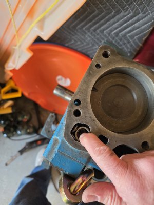

5-10 minutes with the mini belt sander and she slides right in. I cut away from the cylinder and water passage and just rotate the lifter once she is down in there.

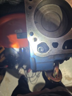

However, there is some casting flash in the way, preventing me from linking up. I have to go coach baseball for a bunch of 8 year old. Will tackle it with a long reach carbide later tonight.
She does drop all the way in and fully seat. I'm just holding it in place with my finger for the pic.
