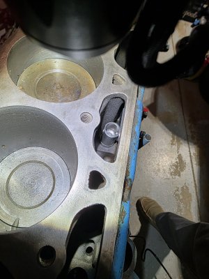

5-10 minutes with the mini belt sander and she slides right in. I cut away from the cylinder and water passage and just rotate the lifter once she is down in there.
However, there is some casting flash in the way, preventing me from linking up. I have to go coach baseball for a bunch of 8 year old. Will tackle it with a long reach carbide later tonight.
She does drop all the way in and fully seat. I'm just holding it in place with my finger for the pic.

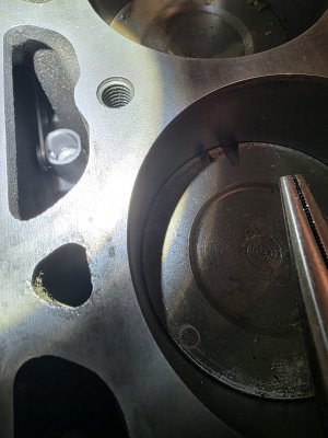

Well, I got them in there and connected! I haven't tried the other end but it looks like it will be pretty much the same adventure. Just took a minute with the die grinder on the casting flash. Need to remove more for actually running the engine but it's good enough for a fit check!

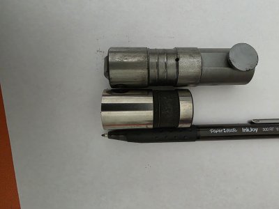

Now I'm just waiting to figure out what it is I am not understanding. This was too easy so I must be missing something...
missing something... Maybe but I hope not. Next step is to try installing a camshaft with the lifters in place and see if the tie bar has enough vertical clearance.

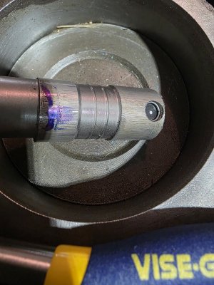

One thing to watch for is, does the indented oil band around the lifter stay in the block lifter bore during travel. If not oil will be lost and so will oil pressure.
Not to jump ahead too far, but if we are considering new roller cam , should really address the cam gear drive pin. Configure it like sbf timing set or whatever is adaptable.
Well, I put in a random cam from the garage. There seems to be plenty of link engagement and lots of room before the oil channel would rise out of the lifter bore. So yes, this is possible. I guess the next 5 year challenge is to find someone who will make a cam. But at least step 1 is done for the 250 block! LoL
