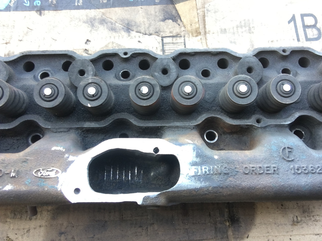

If I mill the '69 M code head to up the compression for my 170 would I still be able to use it later down the line if I upgrade to a 200? I cut up and hogged the intake to put on a 2v plate (i'll edit the post and toss up a pic later). I think I'm going to make the plunge to head swap soon.
