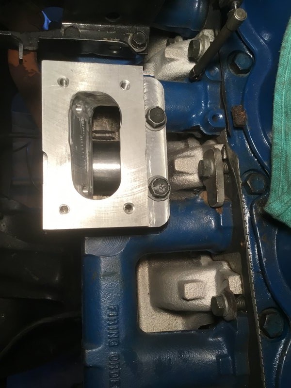

I love old28racers intake. Great thing to copy...a work of art!
old28racer":32fueonn said:
On the following picture of aluminum 2bbl adapter mounted on a modified 240 cast iron intake should my Holley 2300 2bbl carb choke plate face the valve cover?
Econolines is exceptional too
