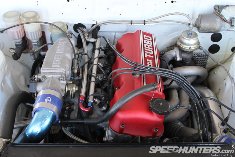

Nice work. I've had about 100 000 miles behind your engine in my Nissan Stagea RS4.
I got to hand it to Nissan. Your Ford might look like a rust bucket, but my 20 year old Nissan was a patchwork quilt of Iron Oxide. Putting the RB25DE into a Futura was a choice made easy!

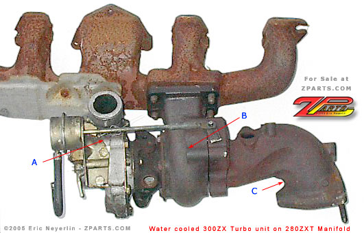

4. Hand made cross over pipe to turbo on drivers side (280ZX, 300ZX, 2.3 Mustang Carb Turbo position to avoid heat soak, copy Fords OHC 2.3 return line)

6. T03 60 series 300ZX Nissan, 280ZX best yet, 1979-1980 2.3T oil supply and return line

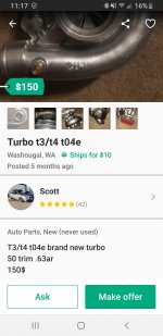

Alright so my search continues for parts.
Heres a T3 turbo for sale, it should this work?
I can't really see the oil line for the L4 turbo, but don't I just drop the pan, and weld in 2 fittings for oil to go in and out?

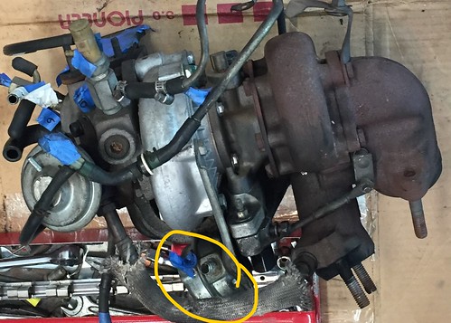

Your best options are finding an earlier TO3 60 from the era well bore EFi, and well before the Thunderbird and Probe IHI RB5.
The TBO302 turbo is an oddball version of a T03. You can use the newer bearing and the problematic carbon seal has a replacement.
It has the right parts to avoid extra fabrication
1979 to 1985-1/2 Turbo Ford 2.3, the carb ones are best. It has the right down pipe and attachments. Don't spend a dime on an ebay turbo.
Put an All Points Bulleten out for it, get it cheep. Then Rebuild it, have the parts crack tested.
