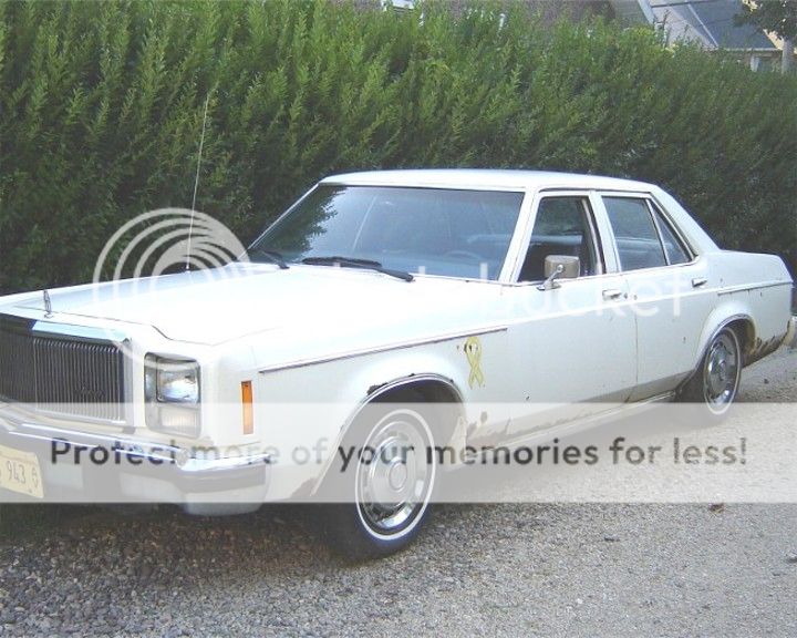

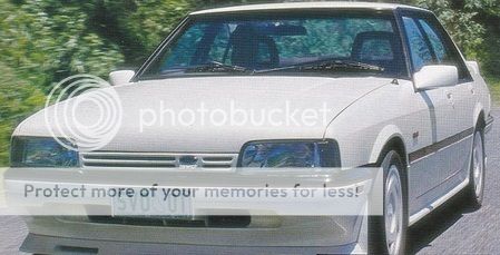

There are some problems with fitting the Barra into the early 60-65/66 Round bodies before the XR revision 66 (Fairlane/69-70Torino based) and surprisingly, the 1975-1980 versions of the US Granada, Mercury Monarch, and Lincoln Varsalies.
The Australians added internal width on the upper spring towers to engineer the under-steer out of the X shells from 1972 to 1996. Front tracks grwe from 56 and 58.5 inches of the 60-65's and 66-70s to a massive 60 to 61.5 inches.
The 1987 XF Falcon
verses the 1980 Mercury Monarch
The US cars kept the spring towers closer, and the 75-80 Granny/Monarch/Baby Lincoln had the spring tower brace removed, and the upper spring towers heavily reinforced, but they are possibly even narrower than the Round Bodies and 69-77 Mavericks.....at the US LH side engine to spring tower clearance is very limited. There is no spring tower brace, though.

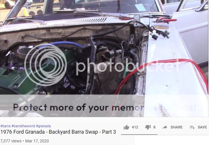

Here is a fairly common 1983 XE Ford Falcon with a Barra 4.0
verses this 1976 US Ford Granada with the same 4.0 Barra.
https://www.youtube.com/watch?time_cont ... S3_tBcozLo
https://www.youtube.com/watch?v=QS3_tBcozLo

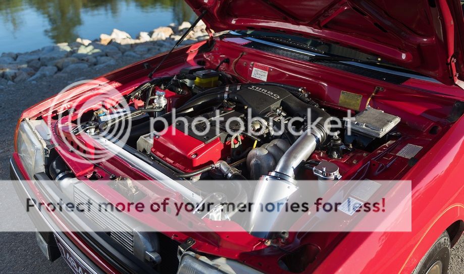

My turbo Barra powered 65 XP Falcon
