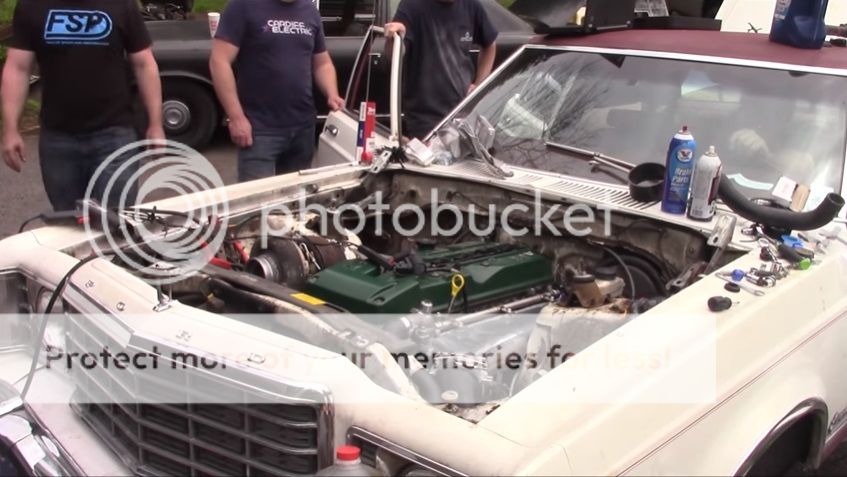

Here is a fairly common 1983 XE Ford Falcon with a Barra 4.0
verses this 1976 US Ford Granada with the same 4.0 Barra.
https://www.youtube.com/watch?time_cont ... S3_tBcozLo
https://www.youtube.com/watch?v=QS3_tBcozLo

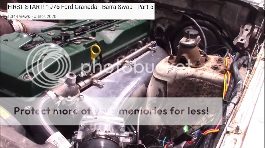

Post #14 by xctasy » Wed Jun 03, 2020 3:18 pm
US SOIL START.
FIRST START! 1976 Ford Granada - Barra Swap - Part 5
Holley HP CPU,

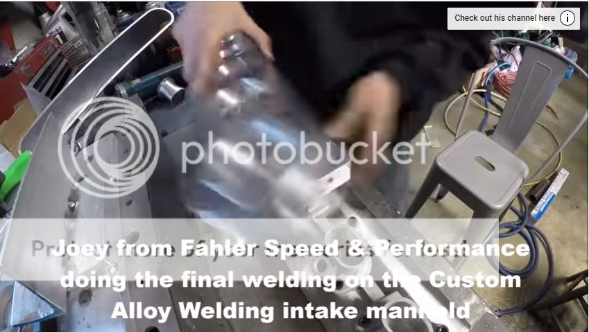

Custom Alloy Welding Australia intake
Aussie Nugget Garage A/C bypass (A/C delete and minus 1-1/2" shorter serp drive belt, )
Fahler Speed & Performance intake to suit the tightest X shell shock towers of all Falcon based chassis cars,
changed to LS coil over plug,
thermostat, upper rad hose and GM coolant sensor.
Volvo turbo
Volvo truck cooling fan
https://www.youtube.com/watch?time_cont ... Z9IYQhyGH0
https://www.youtube.com/watch?v=MZ9IYQhyGH0
Intake care of
