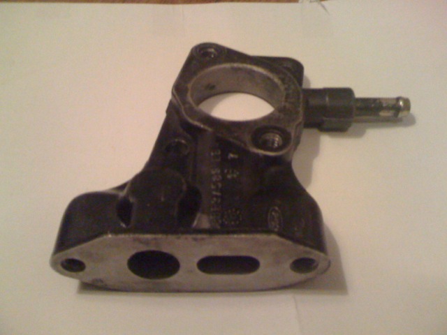

Pre 1980 EGR spacer

Okay...all YFA's got a choke heat line for a few years.
1. Electric choke at the rear with a mystery fabric covered meta hose that has been broken off at the bottom end
The line to the choke used to be, back in the day, asbestos pipe, IIRC...Blue EGR downstream air repair line is fine for running a heat source from the heat stove on the iron header. Somewhere. ludwig's system is good
viewtopic.php?f=1&t=75184&p=578631#p578631
ludwig":1cn8661e said:
The amount of air coming in the choke riser tube is minimal. Soot from the exhaust is a little more problematic IF the wall between 3 and 4 is burnt through. Chances are it is. It should be closed off by tapping and plugging the top and bottom of the choke riser stove. Then you can run an aluminum or copper tube to one of the the exhaust outlets and wrap it around the exhaust manifold a few times. As the manifold heats up, the tube does too and pulls the choke plate open.
This is what I did. The tube and the little collector on the pipe came from a speed parts store. There was no filter in the original and none in this kit.
2. Furthermore most diagrams I'm reading show the PCV running directly to the Purge Control Valve which currently has two ports plugged and PCV running to the base of the carb.
For years, Ford didn't even use the term Positive Crankcase Ventilation. Its a probelm when your trying to find it on the engine, sort of like trying to find Room 13 in a rest home...its not talked about directly on the VECI decel on later cars, and since the first device for emission control was a "PCV" it makes you throw away all literature in discust. I'm indebeted to RED'78 and his foundational breakout codes for 1979.
http://myzephyrs.com/vac_part_name.htm
It requires a cool head to go throw it all without dropping the ball....the code list in the port injection era (1983 for 2.3's and 1986 for 5.0's and 1987 for 4.9 sixes) brought a whole new line of codes, which you find best at http://www.ford-trucks.com. Those guys list everything with a Base Part Number, if its an electrical clip, a sensor, or a part not on the VECI...and there are plenty!
But 1979, still the good old days of 18 feet of pollution control line....
