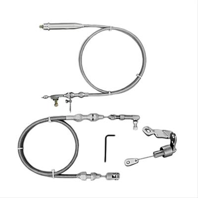

ROFL.... the cost is $575 with shipping for the Lokar pedal assembly and their throttle and kickdown cables with carb linkage.

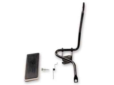

Substituted a '69 Mustang pedal assembly after reading that a number of guys had used them. Here's the parts list:
The first link is a combo kit from Lokar with throttle cable, carb linkage and the C4 kickdown cable. Can anyone see problems with using this setup? The Lokar pedal is a nice design, but it'd stick out like a sore thumb in my stock interior and is expensive. I also read some negative reviews on it.
You might look at the 1970's up 250 Six Maverick's and Comets stock they all use a Cable Throttle and that type Gas Pedal
There are often used factory stock pedals and cables available on eBay - if you're not averse to buying there.
I'm not adverse to buying on Ebay. I went ahead and ordered the new parts from Summit.

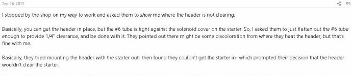

You can flatten the bottom of the #6 tube + flatten the top of the solenoid cover.
Lift up on the rear of the header before you tighten it. Make sure the gasket is up as high as possible over the siamese port.
The header + gasket didn't cover much above the 2-4 siamese port on the eBay header that I test fit on an engine in my garage.
I had to elongate a couple of the lower front bolt holes just to get all the bolts started.
