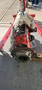

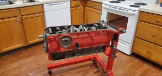

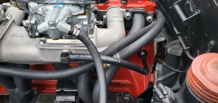

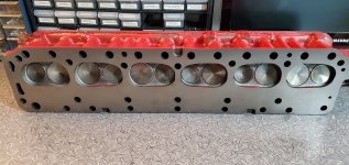

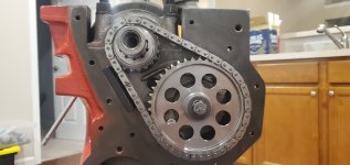

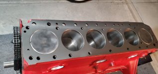

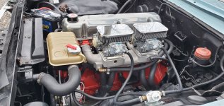

Welp, my project got sidelined by a move...had to put it together in my kitchen. BUT, I got the compression fixed! I had the block milled another .055" to pop my pistons out .005" and took another .032" for a total of .062" off the head. This gave me roughly 62cc chambers and 9.9:1 compression. I converted from road draft draft PCV and got a jet kit for my carbs...immediately had to jump up 2 jet sizes! Here's a video of me letting it loose on a back road, 2nd gear to 70mph at 6000rpm.
Holds 50lbs oil pressure across the board and runs @ 195°. I ended up with a Davis HEI setup and .050" gapped plugs.
I'm very pleased with it now. I plan to build another 223 sometime soon with the supercharger when my garage is finished. The only thing I did different when reassembling is installing the cam straight up, I am going to remove the timing cover thus summer and bump it +4° like I did before which should gain me some low end and a poppier sound at idle.

Hi Bob, there are severial ways you could get to the 9.9 to compression ratio. On GalaxieInline's 223 he said that he did it with the .060 over rebuilder cast pistons (Flat Tops) which he said made for some trouble in finding any good ring sets like Chrome (he also found the last set in the US that only leaves the cast rings in those .060 oversizes) then along lots of machining of the block deck. The orginal block deck cut we don't know exactly but considering how the first machinist didn't do what he asked to do (Zero Deck the Block) we will have to make an educated guess I would say he probally only did the minimum cut in the .002 to .010 range as these 223 block decks usally didn't warp much if any even when overheated numerious times. He just recently milled it .055 this time so maybe it's about .060 total with the piston now setting .005 proud above the blocks deck (instead of the Pistons previously being .050 down the hole). Then along with using a FelPro head gasket of Aprox. .050 crush thickness this ended up giving him a .045 quench distance and putting his 223 inside the sweet spot of .035 to .050 range for a normally aspirated NA engine. To save some time be sure to take a good measurement of how far the Pistons set down the hole of the #1 & #6 with them at TDC, then when it's apart measure the Pistons Compression Height CH (the center of the wrist pin to top of piston) often these rebuilder type piston have a shorter CH then a Standard Ford 223 piston dose. He also milled down the head .062 to get the combustion chambers down to 62 CC's.
Another way would be to use a custom forged piston in a Flat Top with a higher CH or even a Pop Up type and or a longer Conecting Rod such as the only slightly longer 215 rods. You could gain more lenght by using an oversize custom conecting Rod pin bushing and then have the rods rebuilt and machined so that they have the longest lenght you can possable get out of them, also install some ARP Rod bolts first before they are rebuilt. The crankshaft could also be offset ground for a little more stroke lenght.g I would need to know what your plan is on the parts you will be using like the head gasket chooice, and measurements of your block deck height from the piston top, piston chooice, the heads CC's, to be more accurate. Useing a custom forged piston also opens up other more modern ring packs. But if you plan to use the rebuilder cast Pistons or custom Pistons try not to bore the block out any farther than to just get a clean round bore hopefully it would end up at .020 to .030 over but if not you can get custom ring sets made but it's more costly. Best of luck on your 223 build up Robert

Bubba nailed the summary right on the head! One thing I will mention is with a long stroke six it is always nice to get it to oversquare if possible. This means you will have more energy over the rod and the travel of the crank angle before you can't use it due to the angle of the crank.
If I do this again I would do the following:
Surface the block .010 and get forged pistons custom made for .060 oversize and tall enough to pop out of the holes. 005". Why?
1: Custom forged pistons will come with modern easily obtainable ring packs, and will be bullet proof because they are forged.
2: you won't have to spend as much on machining or take as much off your block to obtain positive deck and ideal quench.
3: I think a total of .062 might be what I started with on the head, have yours cc'd before starting and then just run the calculator online to figure out how many CCs to get rid of to up your comp.
4: patriot or custom headers into single collector if it can fit on your car, with a single exhaust to the back. This will help flow at low rpm and torque. It will also save you $$ and having to talk toarry at clifford about warped headers that don't fit lol.
If you have any questions feel free to reach out to me, but yes I have been busy out enjoying my build 😉
