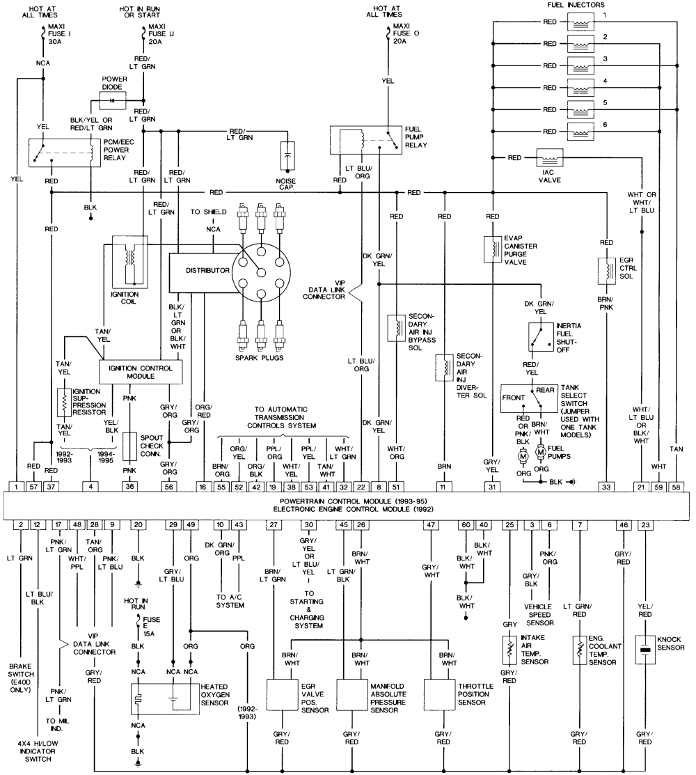

I'm using an Innovate LC-1 wideband O2 system on my Econoline build. Wideband is a must. Only one wire from the sensor goes to the DIY PNP board. Looking at the diagram below (92-95 4.9) pin 29 should run to your 02 sensor, along with pin 49. Use an ohm meter to see which of those goes from the o2 sensor on your truck thru the harness to the connector. Then jump from MS to that pin on the BOB. Then it's just a matter of following the wiring instructions for whatever wideband sensor you're using and tying it into the correct wire(s) in your harness for ground and power. See my Econoline thread for my system diagram that includes the O2 sensor.
Hope that makes sense.... 8)
My ignorance. Pin 29 is the heated oxygen sensor. got it wired up a while ago. Been tuning it, experimenting with timing and A/F Ratios. Its fun. I have to do some mechanical work on the truck now.
