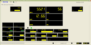

Im doing a QH on my 1990 E-150. I have tuner pro rt downloaded and I'm trying to get familiar with it befor the QH arrives. Can I download the files I want to upload to my ecu now? I don't know anything about this so please explain the acronyms if you use any.View attachment 21533

reading the thread now thanksNice, I assume you mean TunerPro RT? That is the way to go. You will be looking at using the SUB2 strategy if you are running an E4OD. A1C is set up for a V8 and needs quite a bit of work. I would not recommend trying to adapt A1C without Michael's help. We broke out SUB2 which is for your exact setup. The only caveat is it does not have AC idle up functions.
http://forum.efidynotuning.com/viewtopic.php?t=751&start=70
Most of that is development stuff. The file you want to start with is attached to the very last post. They'll probably be a little bit more work to do with it once you have the quarter horse installed, but I'll be glad to help you iron it out.I'm lost in that thread. I read it but I will need some live support when I get the unit.
