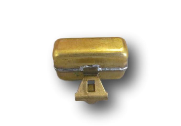

Old ones can and will soak up fuel, they will feel soft were you can stick your thumb nail into them and often see the wet fuel seap out. I would replace it in that case some of the carb rebuild kits tell you to weight themso thats an option too. I have needed to change out lots of them over the years were it got to the point I just picked up a new float along with a carb kit to save me some time. Many carb problems are related to having a to high fuel level and heavy floats do sink and many times that is the cause of it. There are some who have resealed them with a coating I don't know how that worked in the long term the only floats I have ever fixed are the brass ones those are easy and work good every time. Best of luck
I remember your 'handle' from our last site. U know about Mike's for sittin home and gettin carb parts I think. Brass is OK:
the neopreen might B better at avoiding fuel penetration (NAPA delivers too):
