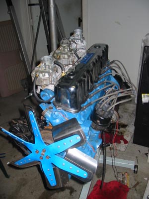

I did a full mock up of the engine today. It is all assembled (minus attaching the head, which will be put in after installation). Here it is. I did some measurements and it looks like there will be just enough room to clear everything.

WOW! I've got to have my buddy see that. He's always saying I should drop a V-8 in my car instead of keeping the 170(sixes suck, no power,no oommph, stuff like that). Wait till he sees that. I think he'll change his mind.
did you paint the fan the blue or did it acualy come like that?
looking great ,,,,nice setup , specialy with that air filter on top of it , realy good looking ,

Thats an unbelievable looking setup you have there! it will be nice to see it back in your car though!
Hey, where did you get that valve cover? I've been looking for one like that for a while now.
Very cool setup!
How will you synchronize the carbs?
How did you make your own adapter plate?

83fairmont: the fan came that color. You can order them Blue, Red, or Chrome I think.
6T6: I got the valve cover from a guy on vintage-mustang.com. I've seen them on Ebay a lot. They usually run about 60-90 depending on condition. I used a single 4V base and cut out the holes for the outer carbs. The large opening for the 4V came in handy so it has room for the auto-choke to operate with out hanging up.

Al, isn't the light blue the correct color?
I have been trying to find examples of correct colors for our 66 coupes. The only info I have is that Corporate Blue is correct for 66’. But what does Corporate Blue look like? I thought that was the light blue.
Either way your fresh build has an excellent balance of chrome and looks excellent in the light blue color. This setup will defiantly catch anyone’s eye at your next show.
