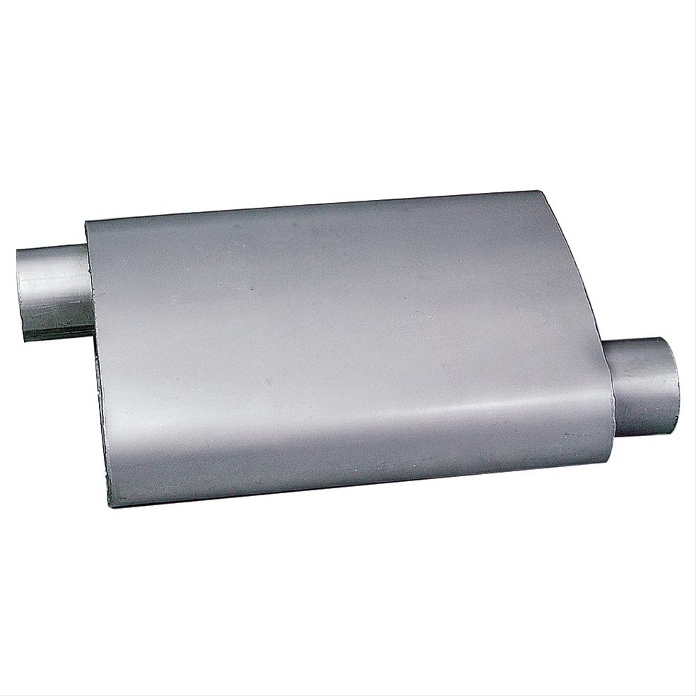

I ordered this muffler today. (Longer case versions are available. I read that the longer case mufflers make less noise.}
Summit Racing SUM-633252
2.5" in-out, offset both ends. Length:13.5 in. Overall Length (in.): 18.5 in. Thickness :4.000 in. Width (in.):10.000 in.
