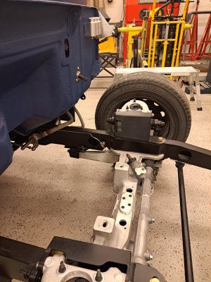

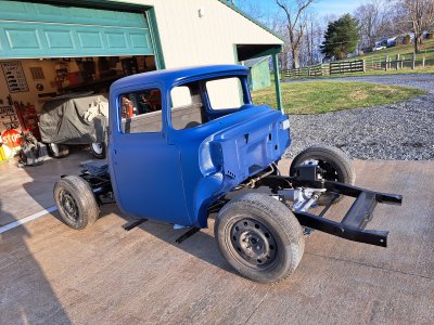

That looks like a Crown Vic / Grand Marquis IFS. Did you narrow it yourself?
Very nice work.

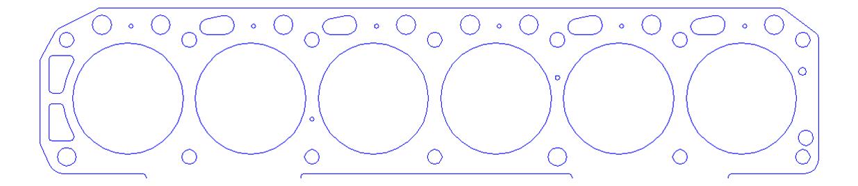

Once he gets the block bored, and valves done we will size the chamber and order pistons. Will also be ordering a head gasket from flatout. Need to order the super charger gaskets as well.
