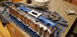

Got the adapter angle milled today. I got it roughlt to 3.5°. It's definitely closer than it was flat milled. Next is to drill the holes into the head. I brought my junk valve cover to make sure it all fits on and allows me to take the VC off if needed.
Then i got to get studs and test fit the carb to make sure the butterflys move without obstruction. Im excited that its almost done!
What I'm happy about too is that its all documented here so others can see what I'm doing in stages so hopefully it makes it easier to see what is needed to be done.
Thanks guys for all the advice so far, keep it coming,

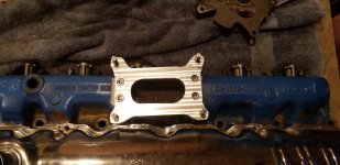

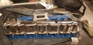

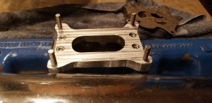

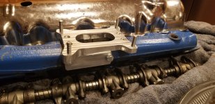

I finally finished it guys. All thats left is filing a few spots that intrude on the intake area and sealing the surface in between. But I'll seal the surface after I get it magnafluxed and all the other head work to it.
Also i made a cover for the EGR valve spot. I'm thinking about drilling and tapping for a vacuum source there, or should i leave it as is? I don't really do anything for vacuum other PCV and my vacuum gauge. But i may add power brakes in the future, I'll decide that after i get my disks on.
So I've heard to use the aircraft grade permatex or to use 1/6" gasket material, i need to decide on that next. What is the poll on that?
Thanks,
Ryan

that really takes the cake (proof is right beside !).
8^ )
I C in 1 pic another adapter below, yes?
Do U have a shot of that to look at?
Is top adapter so thick to get the carb links above the V/C?
Thanks for showin all the pic!.

Haha i thought the cake was a nice touch lol.
The adapter below is my cover for the EGR spot since i wont be running that. If you really want to see that stand alone i can do that for you.
No it is not. The throttle linkage hits on the low side. I need a 1" spacer to clear the log. I ordered one off eBay even though i could make it, but its time i actually start doing the assignments in class instead of this haha.

On the gasket thickness, the flatter the two surfaces are the thinner it can be , and the thicker you go the more distortion you can have when tightened down...How thick is the gasket between the carb base and the body of the carb...It should represent the adapter to manifold surface.
At the top edge of the adapter is it the same size as the carb bore or a touch larger and not smaller?
