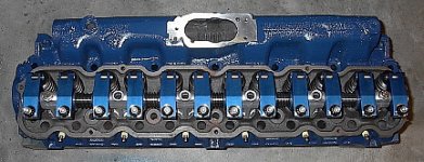

I've seen someone do the 3 bolt thing before and I'm assuming it worked. I don't know how I'm gonna squeeze a 4th bolt hole in it, it was already tight before. I was gonna do 4 in a rectangle pattern but the original bolt hole kinda screwed up my room for that. But it won't be in service for awhile. I gotta be able to afford having the 1.50 exhaust valves put in and doing porting work in the exhaust ports.

different heads I imagine, can't read the casting #s.

I have seen pic before and people do what works for them at the time , but with 20 20 we can usually always improve what has been done by their efforts.

I wasn't planning on reusing the original hole (top one on right side). In order for me to do the rectangular arrangement it woulda cut it too close to that hole. So thats why i went with the 2 and 1 setup. With plenty of permatex, flat sealing surface, gasket, and a .75" aluminum spacer on top, i think it should be plenty sealed. But this is my first rodeo so if I'm talking out my rear here please tell me so i don't waste time putting it on and not working.

The problem with the centered bolt hole is it is the thinnest there and you have only a couple of threads.
I see nothing wrong with using the upper right hole ( in your pic ) But if it is to close to work I see nothing wrong with a new bolt hole straight to to right. and a new bolt hole at the lower right like the one at the lower left, the threads will be thicker there...Maybe forget the center hole..It does not have to be perfect but four bolts more even would be best.
What you have may be fine but why not improve it while you can easily do so now.
I am trying to help the future readers to help them get the best job done.

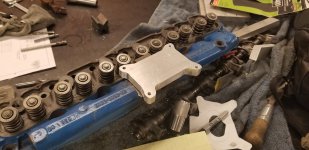

Alright so i decided to add a hole but I'll do it when i finish my adapter. Since all the holes are referenced from the lone one, I'll drill the 2 on the left side in the adapter, then look at drilling 2 on the right side right through the adapter and log.

I'm gonna get the small bore carb gasket and try to make the slot in the adapter plate look like that. The big bore gasket has the holes going into the sealing surface a little bit, so the small bore might just fit, or i may need to funnel the adapter ever so slightly.
I got to work on the adapter today, here's what i got. I'll be working on this again probably tuesday next week. Currently its .75" tall, would you all cut it lower than that or is that probably good?

fit rocker cover before drilling the holes -so you know you can get it past the adapter if you need to remove the rocker cover.
Check your throttle linkage situation on the carb before making it any thinner. Iirc from when I was looking at using the 2100 I needed a bit of height to clear the log.
Good idea. It looks like it will but I'll double check
I'm using a Lokar cable and a little bracket i fabbed. It should work. I'll measure how high the carb was sitting before and make it the same just to make sure
