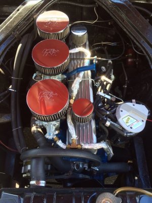

I figure that's pretty much how it's set up now. With the pcv valve/ hose running straight to the center air filter and a breather cap in front (like yours in photo)...... basically the pcv is non functional and it's just a couple breathers.
Not really. A PCV relies on vacuum to open. I doubt there is enough vacuum in an air filter to operate the valve.
Yes, definitely. I'd put a breather where the PCV is supposed to be, just to be on the safe side.
