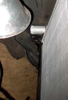

All right, got the new radiator for the Comet ('65) but didn't know that it was going to be a 3-row. I don't have enough space for the original fan. I got a flex fan but without shimming it won't clear the crank pulley. It got dark here so I quit working but it looks like it will hardly clear when it's shimmed enough. I have A/C so I don't have room for a pusher (the condenser is huge). Anybody dealt with this issue? I searched but couldn't find an answer for this particular issue. I'll start messing around with it in the morning but wanted to see if anybody had any thoughts. I don't really want to cut the body up, so any other options?
