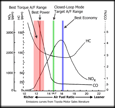

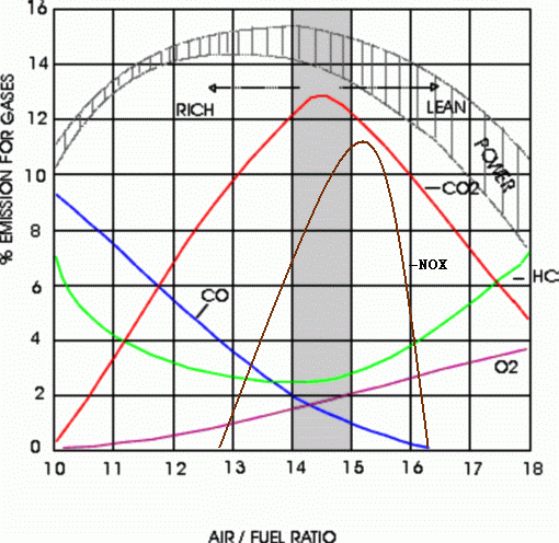

Wide band O2 sensors which give you air fuel ratios are just fine if you have the time and money, but auto engineers went to CO2 readings many years ago to simplify it, and the black CO to AIR fuel ratio in terchange is the easiest system to tune a jet to if the cars under load.
These are the is the graphs...
Toyotas later graph
Black line for CO on the right axis
Crytons graph is the blue line for CO
At 15.1 to 13:1, CO % via the sniffer test is VERY accurate as it drops like a fly in the frost....
Soooo
You could jet up from the stock 61 1946 Holley jet, check your fuel air under 25 mph load at an I/M test station, and stop up jetting when you get to a % CO under load of about 2%, which is a about 13.8 parts or air to one of fuel. 14.7 or 15.1 (..75 to 0.60% CO) is too lean under load for our cars. 4.5 to 5% CO is ideal wide open throttle 12.5:1 one.
This is how we tuned our old propane vehciles in the 80'S for safety, although that was done by allen key and screw, not jet change
Modern ways aren't always the easiest. Every garage has access to tuning gear, rather than pay for individual equipment, you use the I/.M stuff
