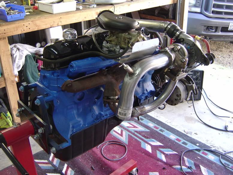

Here is where I sit so far:
Got the head back after over 5 months--
What its going into--
And the almost finished engine--
Just a little update, more to come, hopefully soon.
Kirk

OK, here is what was done this weekend:
The process is going slowly, but efficiently (Don't forget that I have four children, this is b/tw feeding and changing diapers on two of them). It is going into the bronco at the end of this week, ALL RIGHT!
Kirk

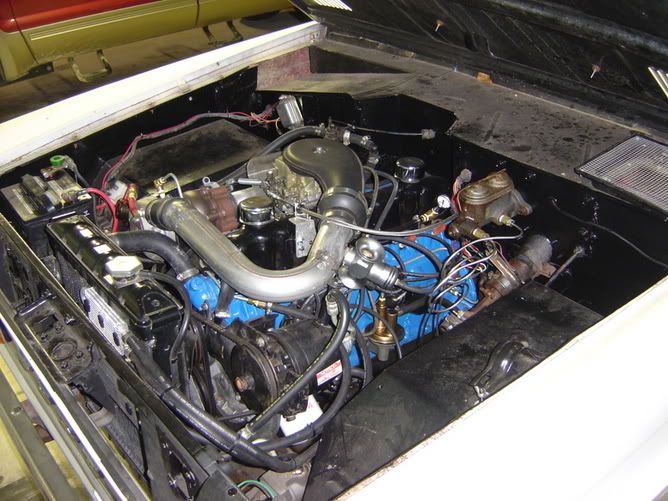

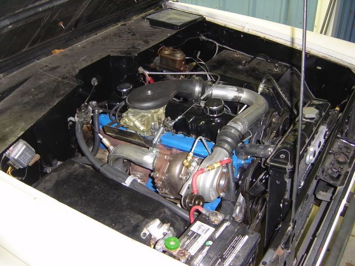

On another note, here are some pics as I promised:
Kirk
