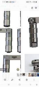

Do you think the lifter bores are taller with the 385 series or the Windsor blocks compared to the six? I was just thinking if the bores are the same height and within the same relation to the cam then if it would work on one of those engines it should work on the six but I could be looking at it wrong.
This assuming their pictures are the actual product.
I don't have an older non roller V8 engine on a stand to check. The Ford calls for the same lifter for the non roller sbf and the 300. I don't have a big block anymore. I only brought sbf stuff to Arizona from Ohio in 2010.

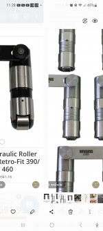

I don't know if I like the narrow band where the oil can get to the holes in the block? They appear to be shorter than the Howards
This low groove may be necessary for your high lift you want?
Maybe but I was just thinking. I know the hydraulic roller is taller than the solid roller, but compared to the bottom of the lifter, I wonder if the oil hole is in the same spot for both? I know people use the solid roller and if they both were in the same spot then it should work for a hydraulic roller?
The retrofit rollers have the bottom section about the same as the stock but the roller is part of that dimension. They appear to be about the same height except the section where the link bars stick up. The solid rollers are shorter because they don't need the hydraulic plunger section. It looks like they still have a section that sticks up high to make sure it is above the lifter bore. Idk how much height you actually save? Someone else would have to chime in with that info.

Ok I just called Howard's cams. Gaterman makes the 385 series lifters for them for their BBF roller lifters. So technically both sets ( Howard's and gaterman) should be the same dimensional. 3.088 from the top of the bar to the bottom of the roller.
