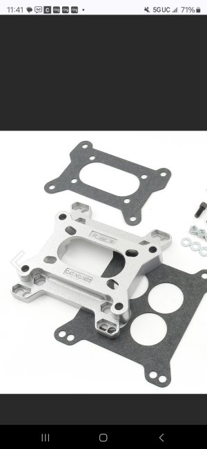

sorry for the delay, not exactly sure how it was going to be mounted I was hoping the adapters in the above post would help and as far as piston and rods ill have to let you know the machine shop will get those and he will modify the large log head for the adaptersHow are you going to adapt a 4 barrel TB to a log head?
What are you going to use for connecting rods and piston?
