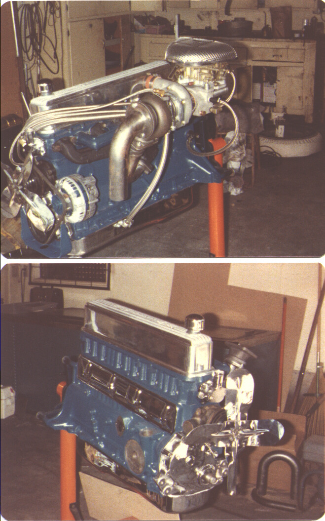

Posts: 6960
Re: 223 "performance" expectation management
Post #21 by xctasy » Sun Jul 15, 2018 8:02 pm
peeeot, this ones for you, and it confirms the grunt out of corners anecdotals of the others in the above posts. Great advice is about the poor mans overdrve automatics and especially the T18 over drive manual gearbox.
And I haven't ever seen an in line six overcarburated yet...
Like I said to dkp_cobra, in "200 vs 223 vs Ford Zephyr 6" Post #6 by xctasy » Fri Jul 13, 2018
viewtopic.php?f=18&t=78549
"If its on questions in a public format, then that is a much better way....that way you get more feedback, and sometimes one person isn't always right".
On the bigger Ford sixes, the stock 1-bbl engine baseline was a low end torque engine with a huge drop in air flow at about 3500 rpm from the 1-bbl carb and the Load-O-Matic ignition. Off the traffic lights, even a 3 on the tree manual gearbox 223 will get out of the whole real good for the first 50 yards, then it looses its ablity to make power and revs. The manual gearbox adds what seams like 25 hp at the back wheels between off idle to about 2800 rpm, then any Cruisomatic Y block starts to erupt forward by comparison. Those old manual i-6's were really strong off the line compared to a v8 slush box, even a good one like the 312 Y was.
With a modern ignition system with a proper advance curve, a bigger set of dual Deuces or a 4-bbl, a nicely reworked 223 with headers and a better cam won't loose any low end torque at all over a stock 223; and past the 2800 to 3500 rpm segement, it'll gain on most smaller Y and FE V8's.
The main handicap to the I-6 is the stock Cruise-o-matic gearing. A wide ratio AOD-E or EAOD gear set would help a 4000 pounder off the line, but the best improvment is the old T18 with overdrive. Wide ratio 1 st and 2nd, direct 3rd, and a nice 0.78 or so over driven top is perfect for a 223 cube six with "benefits" like a proper cam, carb and exhasut system.
In line sixes with manual gearboxes are always very good in the first 60 foot times, and as long as you "stick with a stick shift", you'll then be able to make up gains by having a proper 2 or 2 x 2-bbl, or 4-bbl intake manifold and you really cannot over carb an in line six if the car has a good set of gear ratios and a manual gearbox.
:hmmm: Probably a single 4-bbl 650 double pumper is still able to work on a well modified 223 engine. The old I-6's have lots of port area, and Ford engineers decided to tune them down as entry engines with 1-bbl Holley 1908 or Autolite 1100/1101 carbs just to stop them making a Y block or 332 FE look bad. Air restricted engines always last longer than an engine opened up, so the Ford guys first rule was to restrict I6 air flow. The first rule for perforamnce V8's was to add air flow. Triple dueces, twin Fours, or Paxton Superchargers, and the radical R code 312 camshafts, Fords Y and FE engineers did it all. They never didn anything to any I-6 inthe USA untill about 1987 when the Fuelie 4.9 F truck and E van engines came out, and those engines generally outperform any 5.0, 5.8 off the mark...unless those EFI 4.9's came with the 2.47:1 gear set axle...and a few did. They pull those gears supprisingly well too if they have a 5 speed gearbox
See lasitter's 31 mpg truck with ZF 5 speed and 2.47 gears. It tows! viewtopic.php?t=77441
The 223 and 262's, they are bascially like a Jaguar 3.8 or 4.2 DOHC engine when worked. Plenty of those old twin Cam twin or triple SU or Stromberg CD175 carb engines with autotmatic gearboxes could make 4000 pound Fat Cats move along just as well as a 4000 pound 332 or 352 FE.
In terms of air flow through the cylinder head, even with those crazy four port heads, the old 223 I-6 block engines were very well designed, and they just needed better carburation, some die grinder work, and some better exhaust pipes to open up the flow rates. The worst thing you can do is stick with tall 3.10:1 gears and a stock automatic Borg Waner Modle 8 based MX gearbox...it'll need a looser torque converter and a wider set of ratios if your going to stick with an FMX based gearbox. Factory overdrives were always in the 3.70 to 3.89 ratio axle range.
Basically what works is old late 70's and early 80's General Motors THM 200-R style gearing, with wide lower ratios, and if possible, an over driven 4th gear in the 0.67:1 zone.
The wide ratio electronic gear sets from AOD-E's and 4W70's can be fitted into an old used AOD case, and its FMX length and just needs an adaptor to fit. Then you use 3.89 or 3.7:1 axle gears, and you can run with the de Ville....

This will also perk up a 223.
You just have to keep the boost down around 8lbs, or you'll probably send a connecting rod out the block. How would I know that..... :oops:
Posts: 6960
Post #25 by xctasy » Thu Sep 13, 2018 3:13 am
curts56 wrote:This will also perk up a 223.
A turbo is the cheapest performance modification if done right. A blow trhough turbo using enough excess fuel to ensure each cylinder doesn't lean out allows a truley lovely mid range response that will mack your face look like an early human rocket pilot.
The 223 is as strong as an ox, you just gotta Feed It right, and it'll go like Grease Lightening.
If it were me, I'd look at three YFA Carters, and put a nice US postal Letter Box around them, and have it FED Xtra air via a turbo. Keep the auto, and have some fun. There are sodium cooled valves that fit the head (ex 262, IIRC), and as long as the pistons, cylinders and ring gaps are adjusted to suit a 350 hp engine under 9 pounds of boost, you could take the engine into a 215 hp/245 lb-ft before turbo combo with a good aftermarket Schneider cam grind, and then add a 1.6 boost ratio, and be right on 350 hp and 400 lb-ft.
