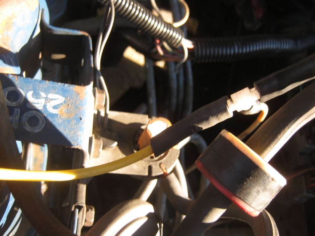

Its easy when you have vac line and emissions line pictures! Then the red, yellow, green and blue color coded make simple sense
The quick answer is the yellow line from the Duraspark goes to the double line to the base of the passenger side of the carb. See 6635, 6636, 6637 and 6741-1 below
that's still not entirely clear to me. It looks like there is a small curved vacuum connection at the base of the carb, passenger side, but this does not appear to be ported vacuum.

Afirmative, it is the spark valve in the carb, but it is a ported vacuum source due to the way it convelutes to the point above the throttle butterfly, not manifold vacuum.
Picture 6636 shows it as best I can.
http://i1215.photobucket.com/albums/cc5 ... G_6636.jpg

The 1978 set up is different, but here are the red, green, yellow and blue hose diagrams to the 1946 carb if it helps at all. Jack uses the red color connector to get his ignition vac
http://vb.foureyedpride.com/showthread.php?t=61971
I'll post the port on pictures 8861 http://i1215.photobucket.com/albums/cc5 ... G_8861.jpg,
8862 for the red coded stuff http://i1215.photobucket.com/albums/cc5 ... G_8862.jpg.
Yellow is 8863 http://i1215.photobucket.com/albums/cc5 ... G_8863.jpg
8864 is idle stop http://i1215.photobucket.com/albums/cc5 ... G_8864.jpg
