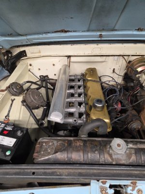

Back at it again. Installing my homemade intake using the lower efi manifold - it interferes at the firewall - naturally. Considering cutting the firewall but..... having 2nd thoughts as the lower efi isn't the prettiest - not sure my upper intake improved it. Original plan was to cut carb plates into the homemade upper once I figured what mixers to use. I currently have a single Impco 225 and was considering dual 225's or dual Impco 425's to get to my 350-400 HP target once my turbo is installed.
Do I cut the firewall and continue with this manifold or try the new Offy C manifold with the heat riser eliminated and spare my firewall but, loose the dual carb option. I am using EFI exhaust manifolds. I started this manifold project during Covid when Offy manifolds were out of stock. I relocated to the East Coast from Vancouver, BC where propane know how was a bit more available. So far I'm not finding the expertise I was hoping for. Definitely my issue but, it really hit me while staring at it and finding I'm not too impressed.
The lower efi manifold has injector ports so could I adapt it to allow use of Propane injectors which would allow me to use a fuel rail where the train tracks stare blankly at me. That could mean I could cut the upper log to plumb the turbo rather than carb plates for mixers and maybe make this thing look a bit better. Is this making sense or is it unnecessarily complicated. Does anyone have ideas for this setup?
