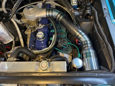

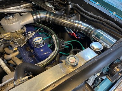

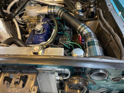

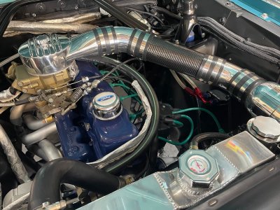

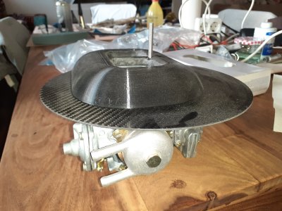

I installed a cold air intake on my 65 hardtop 200 inline a couple years ago.
Used Spectre parts, a piece of 3" carbon fiber tubing from Amazon, and a carb hat that Vintage Inlines used to sell but that part is out of stock at the moment.

I seem to remember a post here that stated the carb hats are not aerodynamically efficient. I am thinking I am going to use the more efficient original style air filter with a snorkel and hook the cold air plumbing to it. Maybe increase the snorkel size too🤔
Yes, I was thinking the original air cleaner would be a relatively simple way to get a good sized air box around the carb opening and the underside could be treated with the same kind of thermal insulation used on the bottom of motorcycle gas tanks to help keep the cold air from being heated up. @zukeeny1 is running the cold air intake exactly where I was planning to do mine. My voltage regulator is there at the moment but that’s not going to be necessary after converting to a modern alternator.
Nice looking engine bay! Is there an air filter in that larger part at the air intake/radiator support?

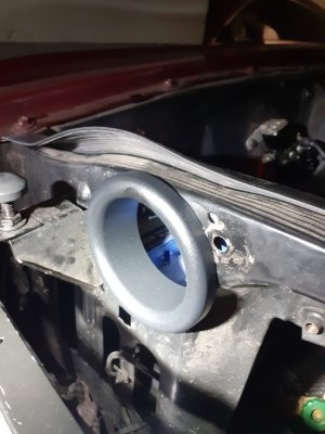

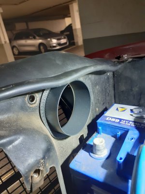

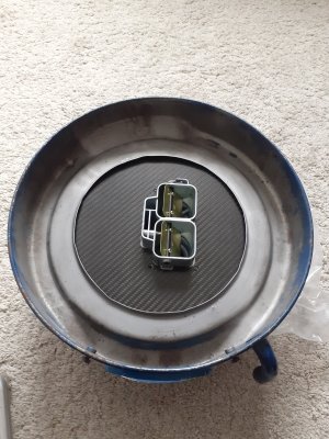

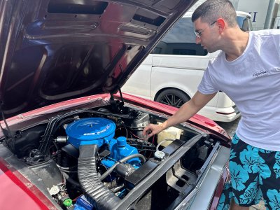

I build a cold air intake with a 38/38 Weber and modified original aircleaner housing (for a 200) in my 68 Mustang.
Cut the a bit off the snorkel and made a 3D printed adapter for the air hose, the inlet in the radiator wall is a generic velocity stack from ebay.
So many questions!! This is what I intend to do on mine but I was planning to use the driver side to keep away from the heat from the header.
@clochard68 How effective is the heat shield you've got between the carb and the log? All of it looks fantastic!
@DON yes, the black part is printed, but i currently don't use it because the dyno testing showed it robbed power at higher engine speed (my guess is because I covered the jet opening too much, I have to redesign it)
@awasson yes initially I also wanted to route it to the driver side. The hose would have been much longer and I wanted to keep that space in case I would install an AC.
The heat shield works very well, I also put some golden reflective tape on the underside of the heat shield and the snorkel.
@clochard68 Is the heat shield carbon fibre or is it something like a phenolic plate? I was planning to do a full length 2 foot by 6 inch sheet metal deflector and either mount it to the header studs or to the inner fender but that deflector you made looks so nice and clean, I may follow your approach.
