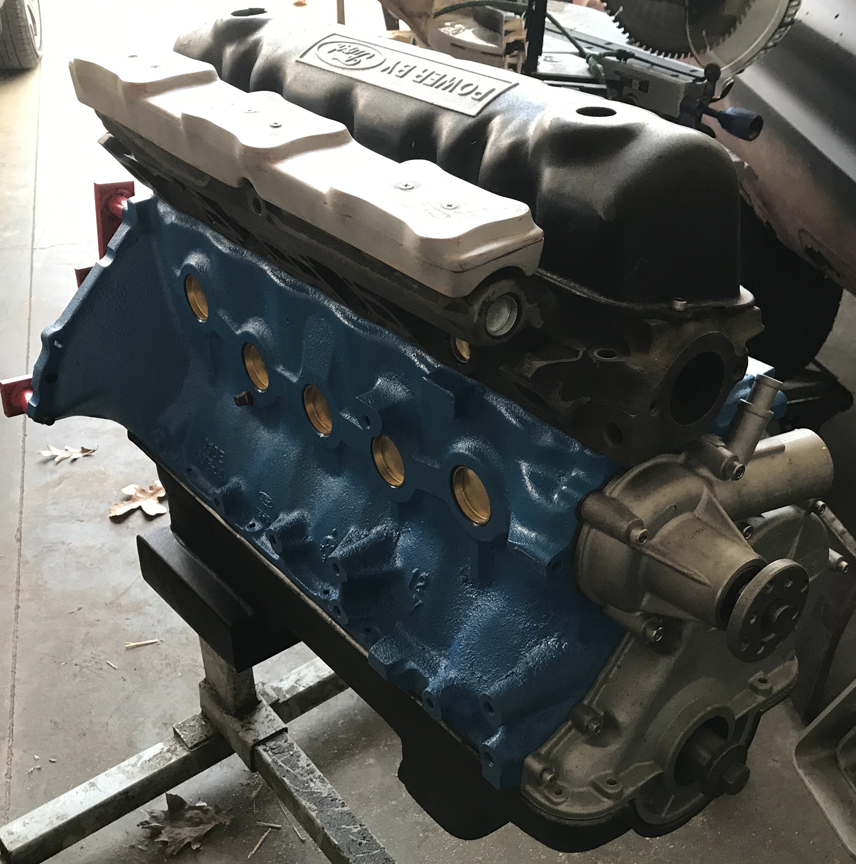

Thanks guys I appreciate any suggestions, even though I have been working on cars a long time (mostly I6, mostly this car
) it has been 30+ years since I have done anything this involved and my first 250 for sure so everyone here is an invaluable source of information and wisdom.
Been re-reading through the Falcon Six Performance Handbook for the 1000th time.

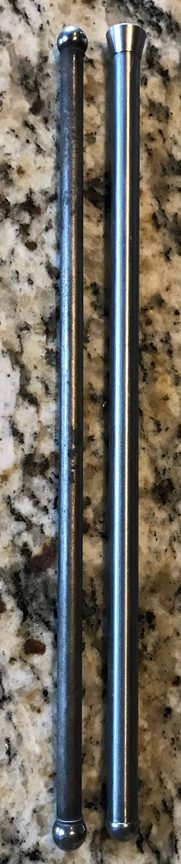

Thanks for the idea I think that is what I will do, I will have to look around for a cup and ball pushrod I have to have something lying around because I never throw out anything :roll:
I will certainly be keeping this thread updated as I work through the rebuild, and will post my sorrows as well as successes

65coupei6":2q496okr said:As for the push rods. you can buy an adjustable rod to help you measure. Or just make one. Just cut the rod in half. thread the ends and use a coupler. (just like your throttle linkage).

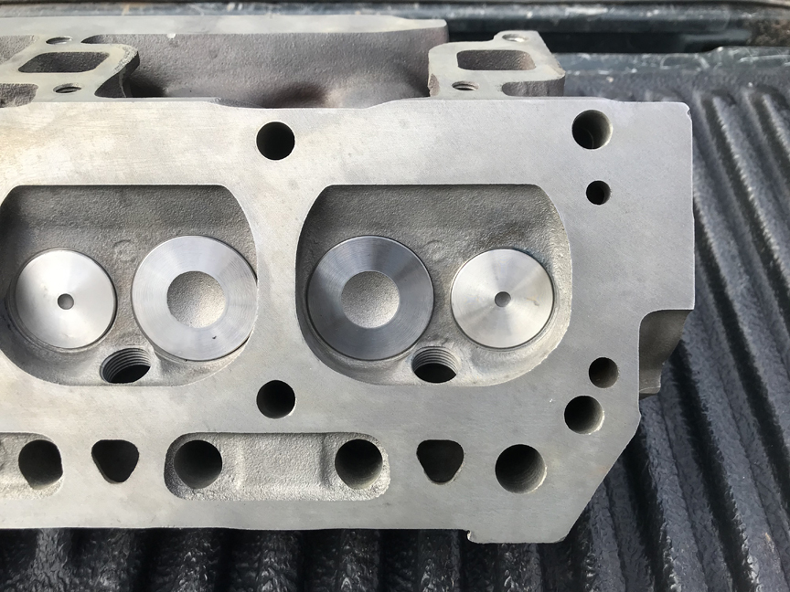

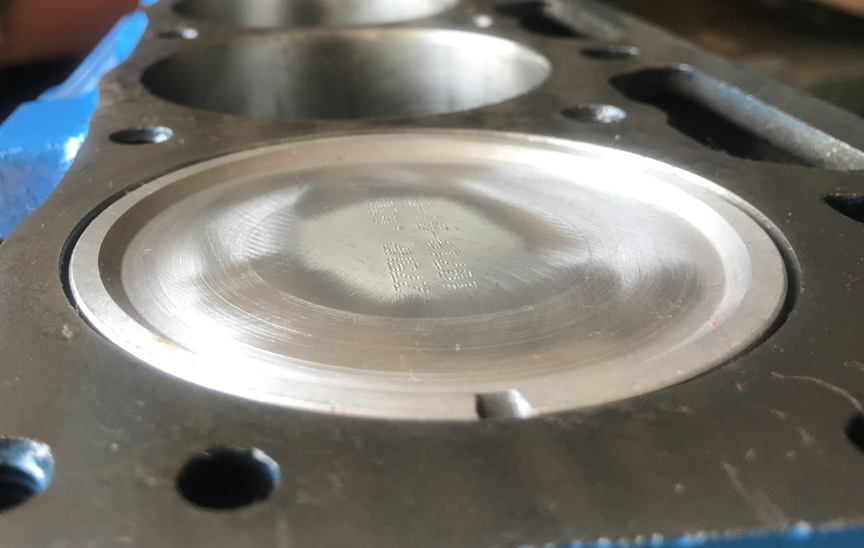

looks like it’s shaping up to a good combo Mike! And you still can adjust it a little with the choice of head gaskets Victor at .044 or FelPro at .050, and if you could find a .020 to .022 steel or copper head gasket you would have about the perfect quench. Good luck
