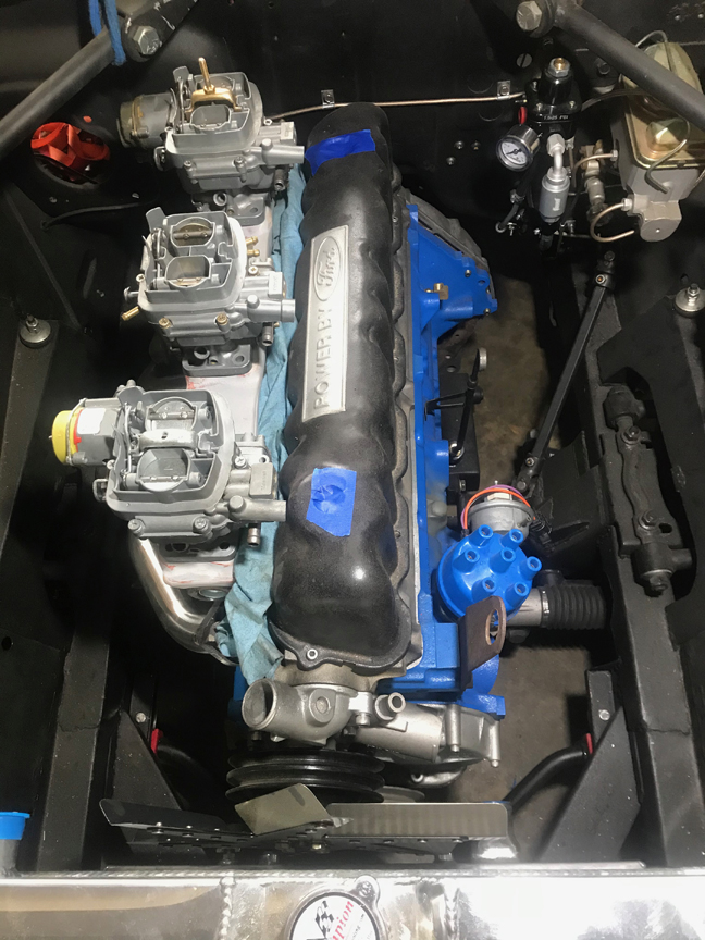

I was out tinkering around today and sat the carbs down on the motor, I don't think I had ever mocked them up on the car yet, front one is getting a little tight on the hood I think so hopefully it will clear, I am going to make some carb hats and duct over to the filter.
