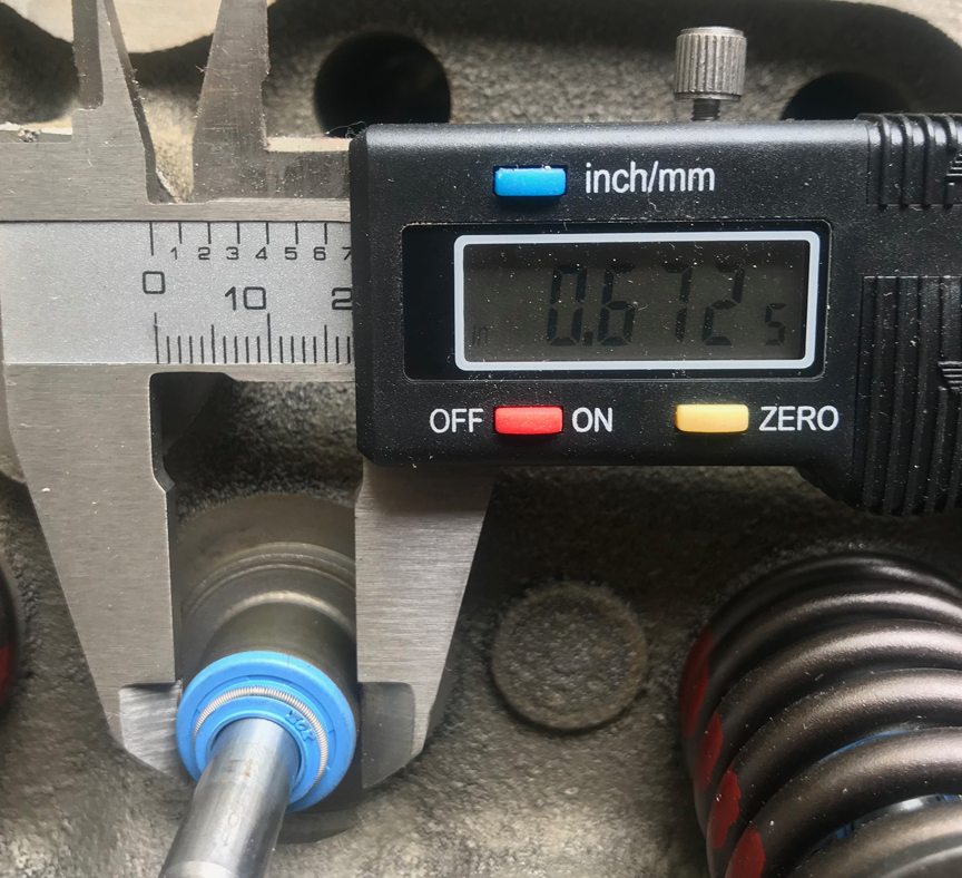

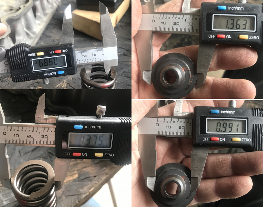

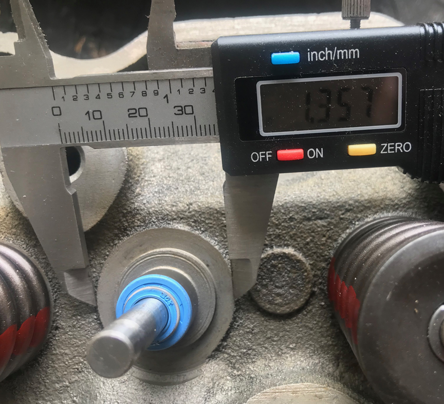

Ok pictures of measurements of the valve spring clearances.
Spring height from seat to retainer - 1.658"
Spring seat diameter - 1.357"
Inside sping seat - 0.983"
Viton Seal - 0.673" (probably not important)
And some more that I just threw in but not needed most likely, measures on current springs and retainers.
Hopefully that is enough if not I can measure more.
Thanks for the help.
See Ya,
Mike
Great set of pictures. Lots if information. Thanks
It looks like a 1.657" installed height at least for that one.
Based on that one a Crane 96803 spring would be 121 lbs closed and 276 open @.470"
The ID of the Crane spring is 1.035" versus .989" for the present spring.
The retainer is not a snug fit in the valve spring with .045" clearance.
That's generally not a problem and a lot of valve spring to retainers are run that way.
If you are OCD like me and you want a snug fit the retainer would have to be changed.
The valve stem diameter should be .310"?
That would be your best choice. They can be purchased in a set of 12, thats a $ saving rather than having to get a set of 16.
The 121# seat pressure will drop 10% after use for several thousand miles.
Go for it.
